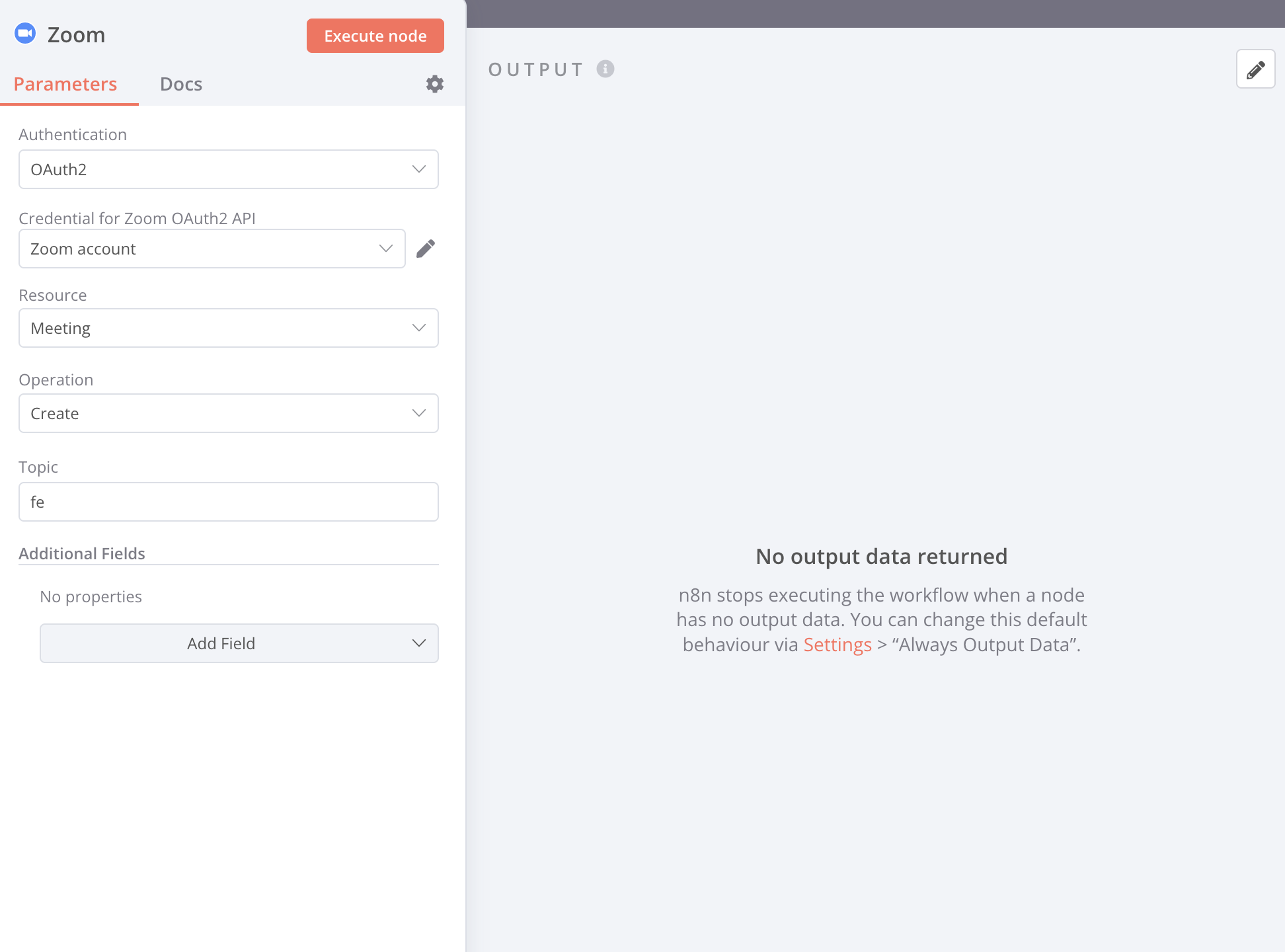

my zoom node is not retuning any output in n8n. but meeting is scheduling in zoom app.
Please help
@Shridhar_Padshetty,
Could you open a new thread and fill out the template provided? The template gives us a lot of information that can be useful for working out why there is no data.
For example you might be on a version older than 0.198.0 which contains a possible fix for the problem you are seeing.
Did you try to pass other parameters as needed in Zoom ??
Yes @chandan988 , everything is perfect. I think issue with version. I have to update and check
