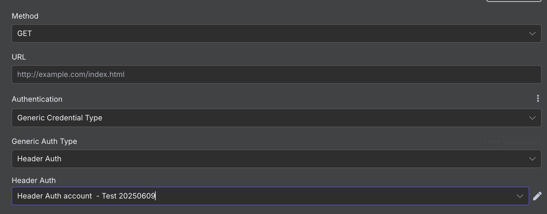

You can just select the credential in the Http request node.
Here is an example for header auth.
