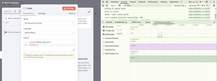

Python code not print in console
I have no output in the console when i print from python code using the node CODE
No error

Hey unfortunately my guess is that they will not support console.log with python. [Using the Code node | n8n Docs](https://Suppported JavaScript Features)
The output should appear in the browser console
On chrome press f12 and open the ‘Console’ tab
