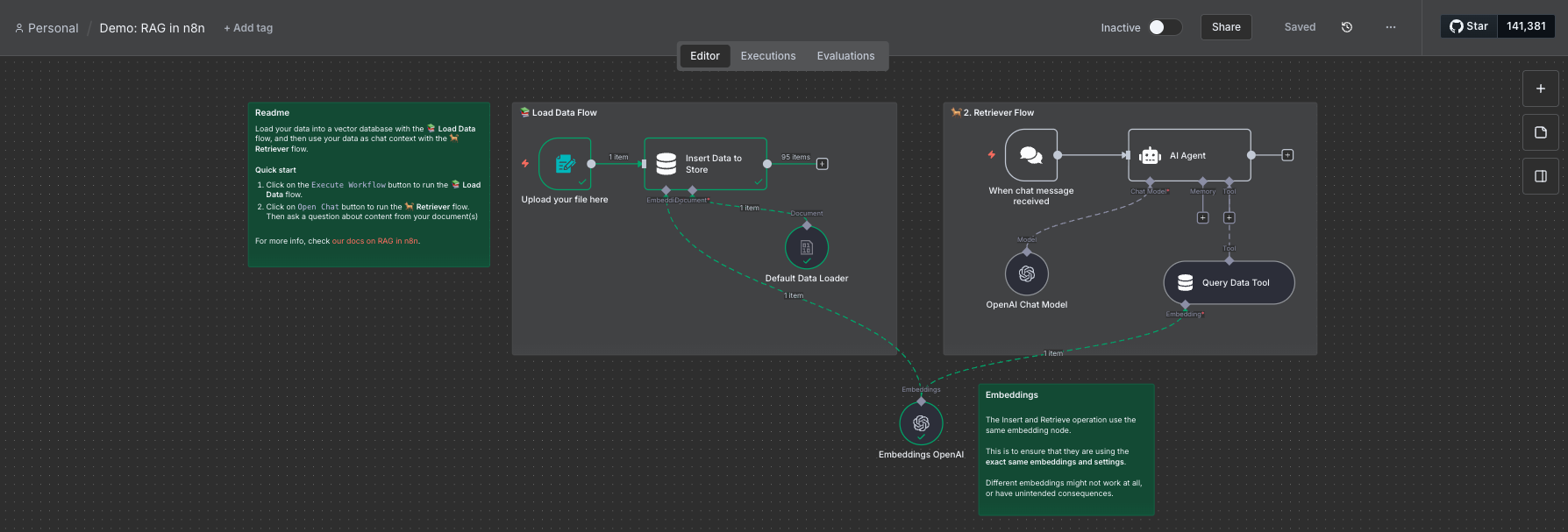

I am running the “Demo: RAG in n8n” workflow. When I start running,
  1. It show file upload screen and I uploaded PDF file.
  2. “Load Data Flow” part seems to be executing fine.
  3. When I ask a question, it does not use the Data Store.
It gives some random result or sometimes say the information is not available.
Can someone please help me and let me know what I am doing wrong.

Thank you all for your help. With your guidance I managed to find out the issue I faced with my workflow. Since I am running locally I used google/gemma-3-1b model. Looks like it does not use the tool to get the data properly. I downloaded openai/gpt-oss-29b model and tested with proper prompts as you have guided and it worked. Then I downloaded google/gemma-3n-e4b model, and it works with that too.
