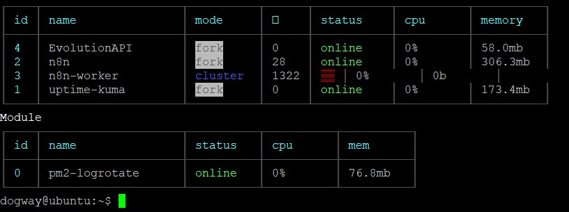

1
I have this problem for almost two months, and it’s only in queued mode either running manually or triggered. The jobs keep stacking as queued so I have to cancel them.
In pm2 logs I get this:
3|n8n-work | Last session crashed
3|n8n-work | User settings loaded from: /home/dogway/.n8n/config
I’m on v1.88.0, using one webhook and worker instance each (for testing purposes) on the same VPS, without using Docker to reduce overhead.

And the N8N_PORT for each, here worker.env is 5678 since this is a bug on the n8n part. This change worked for 2 weeks or so, but then stopped working (maybe after an update?). I’m running Redis in Hybrid mode.

Upon pm2 stop n8n-worker:
3|n8n-work | Failed to shutdown gracefully
3|n8n-work | Error: Failed to shutdown gracefully
3|n8n-work | at ShutdownService.shutdownComponent (/home/dogway/n8n/node_modules/n8n/src/shutdown/shutdown.service.ts:113:29)
3|n8n-work | at /home/dogway/n8n/node_modules/n8n/src/shutdown/shutdown.service.ts:99:52
3|n8n-work | at Array.map (<anonymous>)
3|n8n-work | at ShutdownService.startShutdown (/home/dogway/n8n/node_modules/n8n/src/shutdown/shutdown.service.ts:99:18)
3|n8n-work | at ShutdownService.shutdown (/home/dogway/n8n/node_modules/n8n/src/shutdown/shutdown.service.ts:79:31)
3|n8n-work | at process.<anonymous> (/home/dogway/n8n/node_modules/n8n/src/commands/base-command.ts:279:25)
3|n8n-work | at Object.onceWrapper (node:events:633:26)
3|n8n-work | at process.emit (node:events:518:28)
3|n8n-work | at process.emit (/home/dogway/n8n/node_modules/source-map-support/source-map-support.js:516:21)
3|n8n-work |
