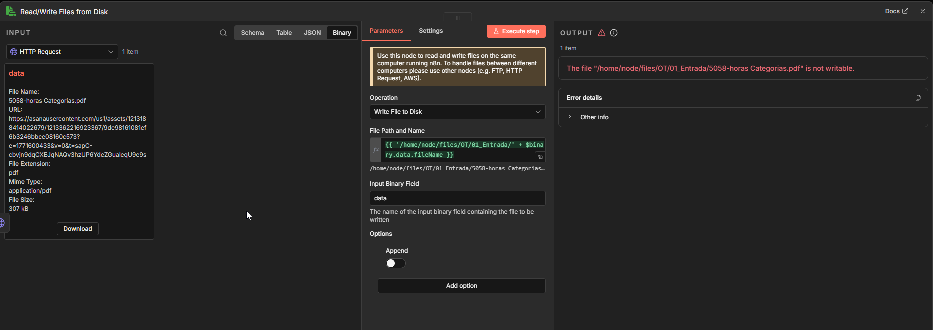

Good morning, I'm a beginner with n8n, and I'm having trouble reading/writing files from disk.
I have a workflow that works fine up to the HTTP request, but when I try to write PDF files to disk, I get an error saying I can't write to disk.

The folder where I want to save the files is c:\n8n_files\OT\01_Entrada. In n8n, it shows up with the "Mount" message.
If you can help me, I'd be very grateful.

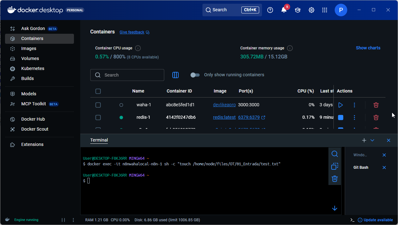

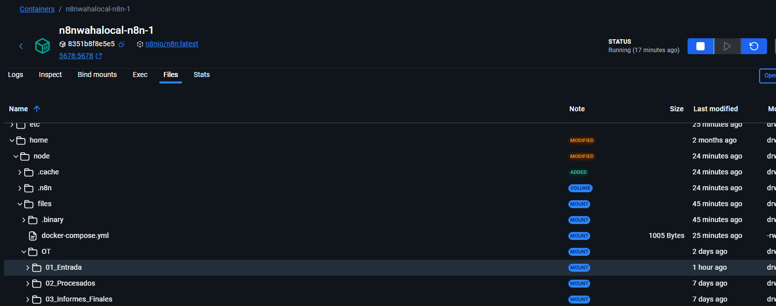

Looking at the screenshots, the folder structure exists inside the container at /home/node/files/OT/01_Entrada/ which is good, but the write still fails even with the path fix. Since you’ve already tried the N8N_RESTRICT_FILE_ACCESS_TO change and it’s still blocking, try running docker exec -it n8nwahalocal-n8n-1 sh -c "touch /home/node/files/OT/01_Entrada/test.txt" from your terminal to see if the container can actually write there at all — if that fails too then it’s definitely a Windows/WSL mount permission issue and you’ll need the user: "root" line or to fix the folder permissions on the Windows side.

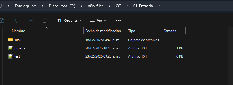

Good morning. Thank you for your responses. I couldn’t reply over the weekend because I was busy with construction work at my house. Here’s a screenshot of the test you mentioned. The test worked to generate the “test.txt” file. I had already run the test, and the “test.txt” file was from a previous test.

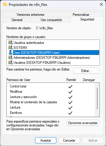

Regarding folder access, User, System, and admin have full control access. I’m still trying things out.

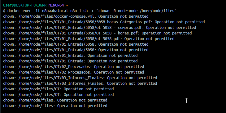

Interesting, so the touch command worked from inside the container which means the mount permissions are actually fine. The issue is probably that n8n runs as the node user by default but your exec command ran as root. Try adding user: "root" to your docker-compose like was suggested earlier, or alternatively run docker exec -it n8nwahalocal-n8n-1 sh -c "chown -R node:node /home/node/files" to give the node user ownership of that directory.
Good morning. Thank you for your responses. I performed the test, and the result is:
