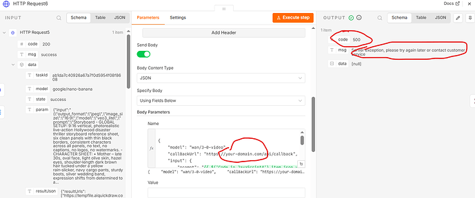

Receiving error again n again plz help
kindlygive steps to solve problem or team solvethis on my behalf ,

@J_Da
This is expected
Help yourself by providing more context.
More info = more help
This error means there is a problem from kie API side. Not from n8n.
Check with the API provider instead.

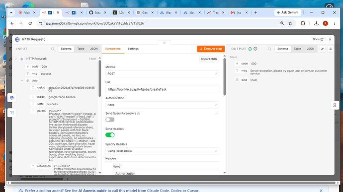

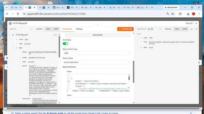

Hi @J_Da, your second screenshot shows the complete JSON pasted into Name, while Value is empty. Name expects a parameter name, not the whole request body.
In HTTP Request6:
  1. Keep Body Content Type set to JSON.
  2. Change Specify Body from Using Fields Below to Using JSON.
  3. Paste the complete JSON object into the new JSON field.
Also remove callBackUrl for now. https://your-domain.com/api/callback is an example URL, and that parameter is optional.
Run the step again. If it still returns code: 500, share the resolved JSON body from that field, with secrets removed.

Hi @J_Da, I checked both screenshots. The second image shows the complete JSON request pasted into Name, while Value is empty. That sends the wrong body structure to Kie.
As Anshul mentioned, fix HTTP Request6 like this:
  1. Keep Send Body enabled.
  2. Keep Body Content Type → JSON.
  3. Change Specify Body → Using Fields Below to Using JSON.
  4. Move the complete request object into the new JSON field.
  5. Check the resolved expression preview: it should show an object containing model and input, with the required values populated.
  6. Execute that node again.
There’s another detail worth checking: the output shows code: 500 inside the response body. That doesn’t necessarily mean the actual HTTP status was 500.
Enable Options → Response → Include Response Headers and Status to see both. If the HTTP status is 200 but the body contains code: 500, Retry On Fail alone won’t catch that application-level error. You’ll need an IF node checking the response body and a controlled retry path.
Fix the body configuration first. If it still fails, share the resolved request JSON with credentials removed, plus the actual HTTP status. The screenshots establish the body configuration issue, but they don’t show whether another API validation problem remains.

Your second screenshot shows the complete JSON in Name with Value empty. Here’s the correction:
  1. Open HTTP Request6 and copy that JSON before changing settings.
  2. Keep Send Body enabled and Body Content Type set to JSON.
  3. Change Specify Body to Using JSON, then paste the complete object into the new JSON field.
  4. Remove the example callBackUrl for this test. Check model and input against Kie’s Wan 3.0 requirements; ensure expressions resolve correctly.
  5. Under Options, add Response and enable Include Response Headers and Status. Set Response Format to JSON.
  6. Execute once. Check statusCode, body.code and body.data.taskId. Code 200 plus a task ID means submitted, not finished.
If HTTP is 200 but body.code is 500, use IF to flag failure; Retry On Fail won’t detect that alone. Avoid automatic retries that could create duplicate paid tasks.
