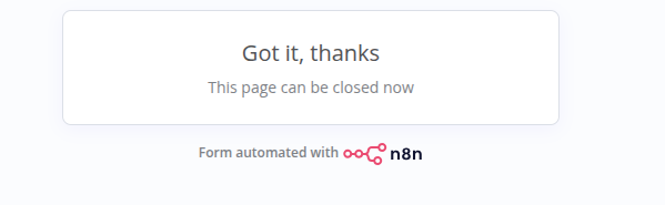

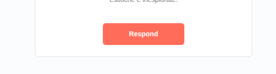

How can I remove this appended n8n signature in the “Send and Wait for Response” Gmail Node? I don’t see a toggle in the options like the normal Gmail “send message” node
Shows another signature on button click, and that page doesn’t close automatically.
Can that message be customized with full page html, or text + icon?
I would love to make the experience better with a giant green confirmation CheckMark in the center + a message, and close it automatically after 3 seconds (I have the same thing setup with Webhooks)
Or setup a url redirect on button click that I could redirect to a webhook that returns an HTML page, or a custom page I have.

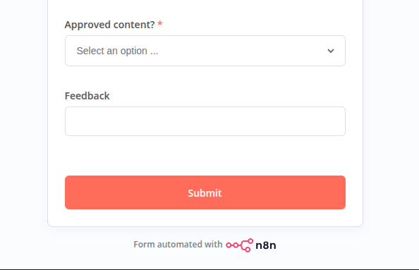

I’ll throw my hat in the ring as far as customizability goes. We need more abilities! I’ll start by saying there is differences between which email host you send to gmail v outlook which I’m not worried about. When I go to the respond page everything is center justified, which is annoying for a case where the output is mainly text. What about some simple css override abilities?

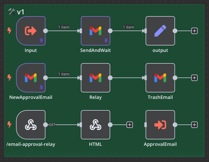

I’ve actually built a relay system/wrapper for the Send and Wait feature as described in my previous message.
The email being sent is custom HTML with the original message extracted from the original n8n default email.
That HTML node on the bottom is a custom HTML that displays the message after the message gets approved or rejected, and sends an HTTP request to the original n8n button on the background when the user opens it [Just a simple countdown while it sends to request, then it closes the page automatically after 3 seconds]

This is impressive. Great work. I’m about a month into this journey so your initial message seemed daunting, but the diagram makes this far more manageable. I have plenty of development experience, but n8n and no-code is very humbling to say the least.

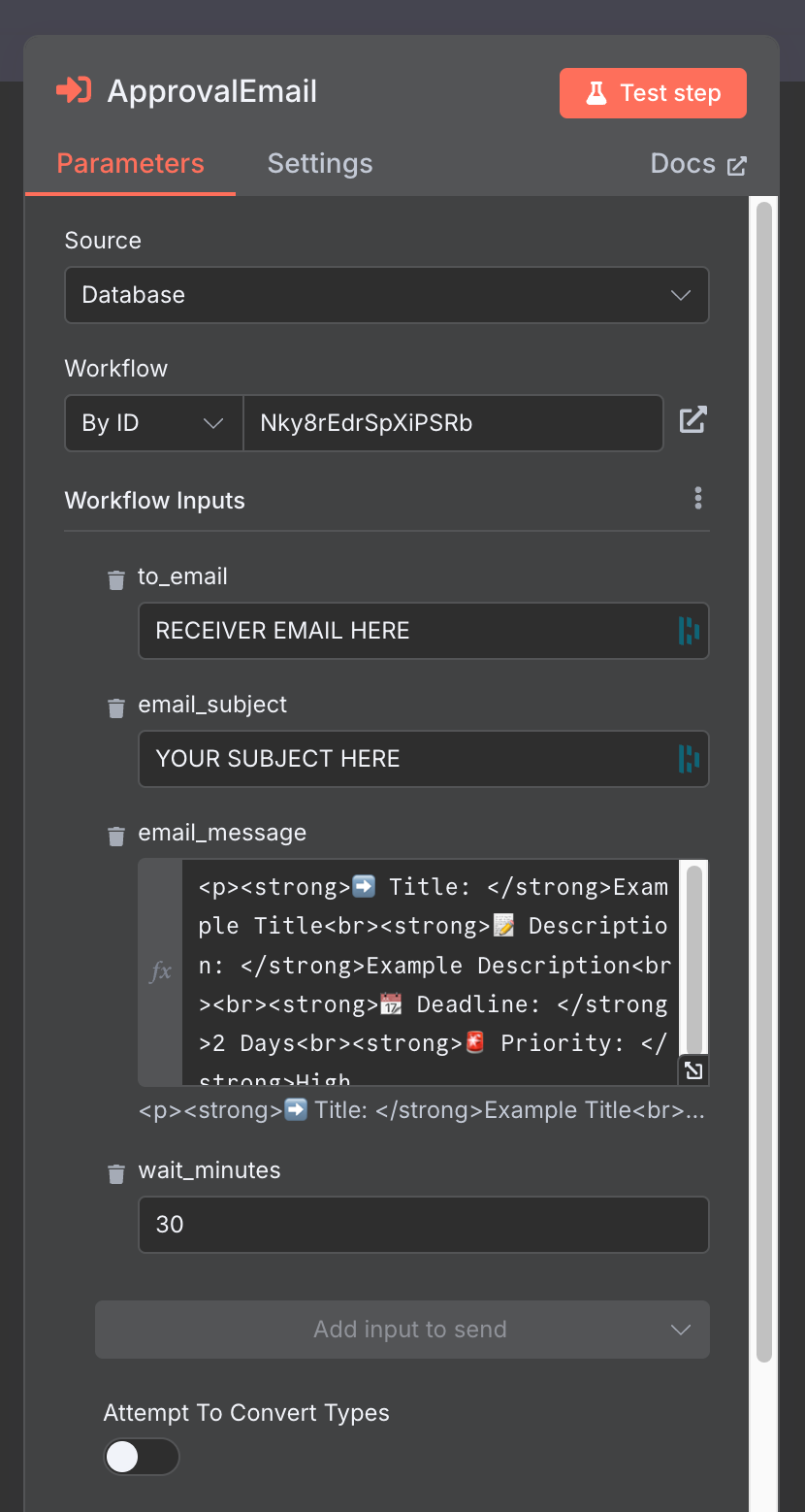

Here you go

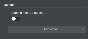

You can from here
But it’ll still show when the user clicks, it’s not fully whitelabel.
I’ve already shared a fully branded workaround here a few months back:
The toggle hides the attribution on the first email, but it still visible on the second step of the process:
