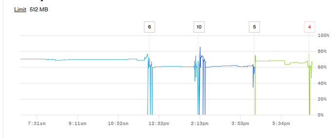

Any time I use the basic LLM call or agent node, I hit a memory leak issue. I’ve updated from 2.13 to 2.14, no luck with it.
I am using a super small Render instance, with 512mb memory and 0.5 CPU : is that too small ?
I don’t see any issuer in the metrics though, at worst I get an 80% RAM consumption (the spikes here is the service being down with zero RAM consumption, not a full RAM)
This seems highly specific to the LLM node. Not 100% reproducible either.
I’ve setup the “N8N_PROXY_HOPS” env variable to 1 in case it was related but it doesn’t seem so.
Can reproduce with Basic LLM Chain, AI Agent, doesn’t depend on the model or complexity of the workflow.

Fixed by upgrading to the 25$/month instance with 2gb RAM, farewell to my money…
Conclusion : if you need a Europe zone, switch directly to your own VPS on OVH or Hetzner, it’s a lot of config but it’s definitely way less expensive.

512MB RAM is too small for LLM nodes in n8n. The AI Agent and Basic LLM Chain nodes load the model response into memory and Node.js
heap fills up fast — this is a known issue since 2.13.
Two options:
1. Upgrade Render instance to 1GB RAM minimum — this is the real fix. LLM nodes need headroom. With 512MB you’ll keep hitting this
regardless of n8n version.
2. If you want to stay on free tier — add this env variable to your Render service:
NODE_OPTIONS=–max-old-space-size=400
This caps Node.js heap below the 512MB limit so it fails gracefully instead of crashing the process. Won’t solve the root cause but
reduces crash frequency.
The spikes dropping to 0 RAM in your chart = the process is crashing and restarting, not a memory leak in the traditional sense.
It’s OOM kill.
