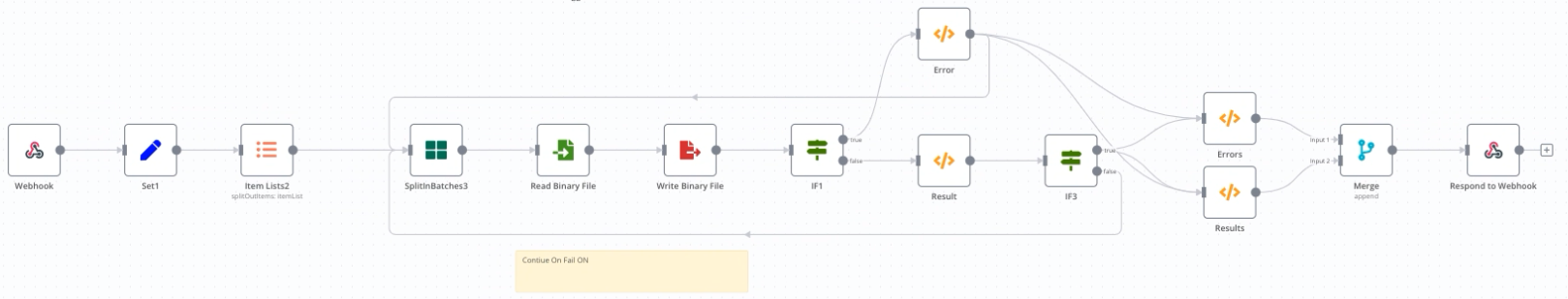

An example of Desktop App specific workflows that I've got running for one of my customers:
… checks if a server volume is mounted, and if not mounts it …
… gets files from externally stored containers on a FileMaker Servers and move them to the corresponding project folders on a file server …
