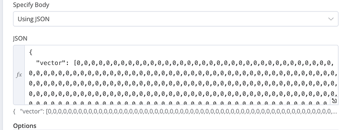

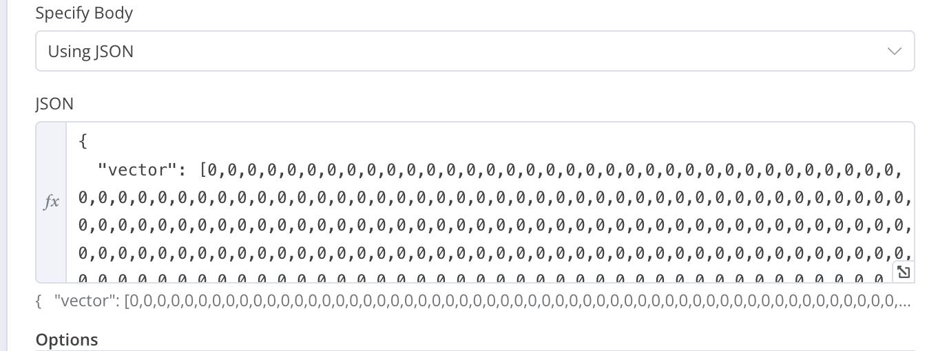

As a workaround, I’ve ended up sending a vector query with 3,072 0’s so that the vector search will return everything. (I’m using text-embedding large, so if you’re using a different embedding then you’ll need to do a different number of 0s)
