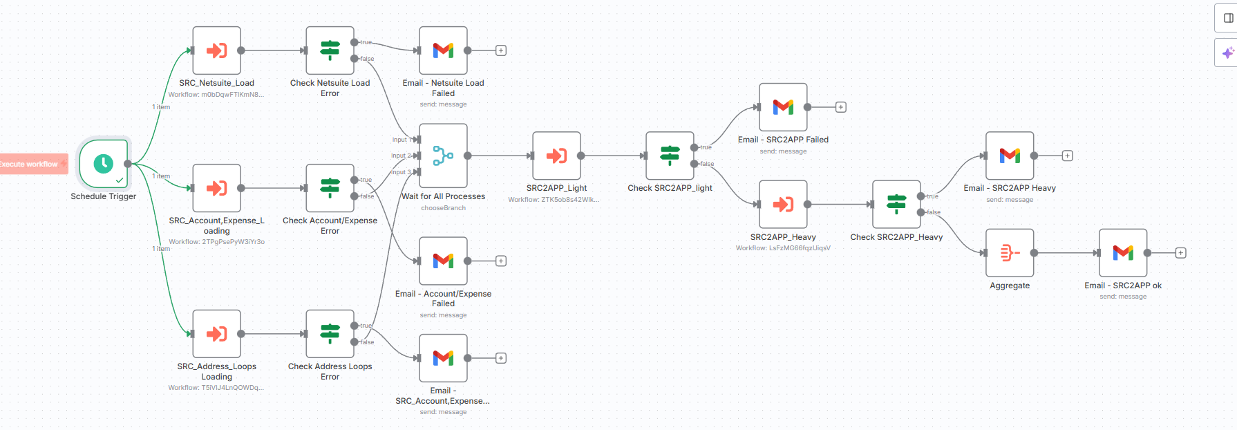

i have process which suppose to run daily at 06:00 AM UTC (or 8:00 AM Israel time) and it doesn’t work after defining it and activating it.
in this example it is set to run at 10:35 AM Israel time
this is the entire process
can you please assist ?

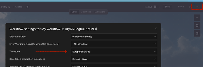

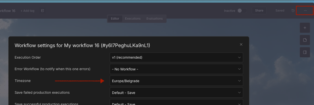

Make sure to choose the correct timezone from workflow settings.

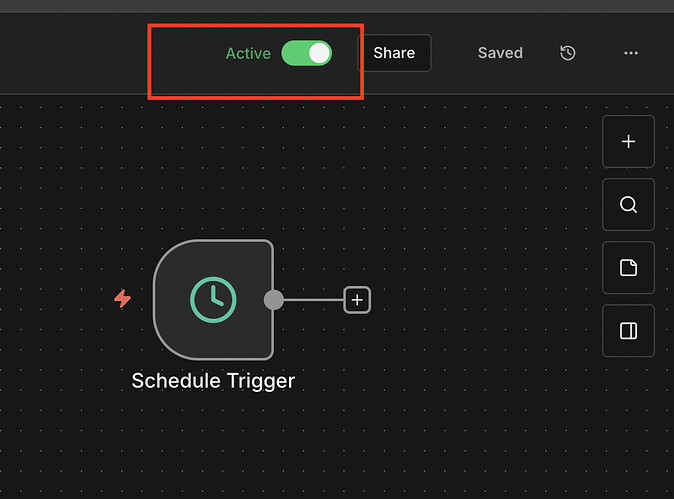

the workflow now is active (it is toggled) and it is set to run at 16:35 UTC, we will see if it works now. what does this toggle mean by the way?
You must have the toggle enabled if your workflow is started using a trigger, so for example webhooks, schedulers, etc. So in your case the scheduler was effectively disabled because the workflow was not enabled. It is also how you can disable the scheduler again if you want to pause the executions in future for whatever reason. Im sure this should solve your issue now
You can read more in the documentation, specifically this step:
You mean you had the workflow toggled off this whole time… I think @Wouter_Nigrini did solve your issue after all :smile:

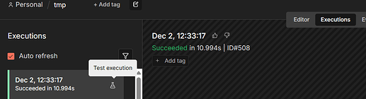

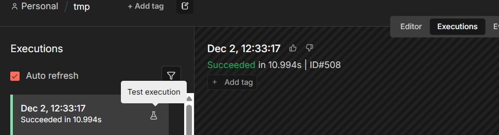

Activating a workflow means that it will run automatically every time a trigger node receives input or meets a condition. By default, all newly created workflows start deactivated. Basically, nodes like Schedule Trigger, Webhook Trigger or service specific triggers require the workflow to be activated in order to work. When you view past executions from Executions tab you see this little icon next to them. This icon means the execution was manually triggered(e.g. when you click Execute Workflow button on the canvas).
Executions that don’t have this icon are production runs. These are automatic executions that ran when the workflow is active.
