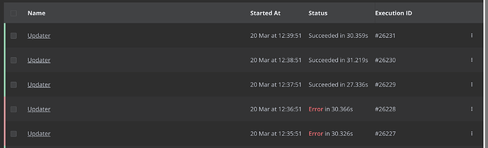

I have scheduler trigger workflow which should trigger every 2 hours. I used this cron expression: 0 */2 * * *
But as I saw in my executions, it triggered for like 2-3 intervals, but then completely stopped triggering every 2 hours.
And there is no error messages. The workflow simply didn’t trigger.
To test this fast, I have changed time interval to trigger every minute. And the same problem: it triggers for 4-5 interval attempts, but then stops working suddenly.
Here is the executions:

It triggered for like 3-4 attempts every 1 minute. But after that, it returns this error:
ERROR 2025-03-20T16:10:00.001944Z Error: ERROR: You specified an invalid date. at CronTime.getNextDateFrom (/usr/local/lib/node_modules/n8n/node_modules/.pnpm/cron@3.1.7/node_modules/cron/dist/time.js:136:19) at CronTime.sendAt (/usr/local/lib/node_modules/n8n/node_modules/.pnpm/cron@3.1.7/node_modules/cron/dist/time.js:98:25) at CronTime.getTimeout (/usr/local/lib/node_modules/n8n/node_modules/.pnpm/cron@3.1.7/node_modules/cron/dist/time.js:110:34) at Timeout.callbackWrapper [as _onTimeout] (/u
