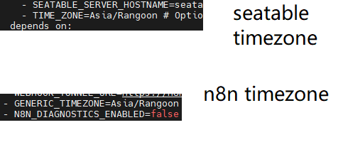

I am using selfhosted n8n and seatable. and below is timezone setting in docker-compose.yml
It does not seems to work. below is seatable trigger setup.

Hey, you would only need to set the SeaTable time zone to UTC as per their example docker compose file:
TIME_ZONE=Etc/UTC
This is the time zone they use for the created timestamp of a row and also the time zone used by n8n to query these.
The n8n time zone can remain unchanged.

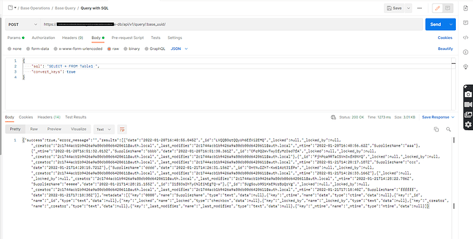

If this still fails, would you be able to manually run an SQL query against your Seatable database and check whether you can fetch the newly created row using a query like SELECT * FROM Table1 WHERE _ctime BETWEEN BETWEEN "YYYY-MM-D HH:mm:ss" AND "YYYY-MM-D HH:mm:ss"?
This is the exact query used by the Seatable Trigger node when your workflow is active (where the first timestamp is the last polling time and the second one is now). Please replace Table1 with your actual table name and the timestamps with a second before and and after your row was created using UTC time.

anyway i try to manually query using SQL query to see if i am able to do so.
I guess I’ll either have to self-host Seatable or wait for the timezone setting in the trigger node then!

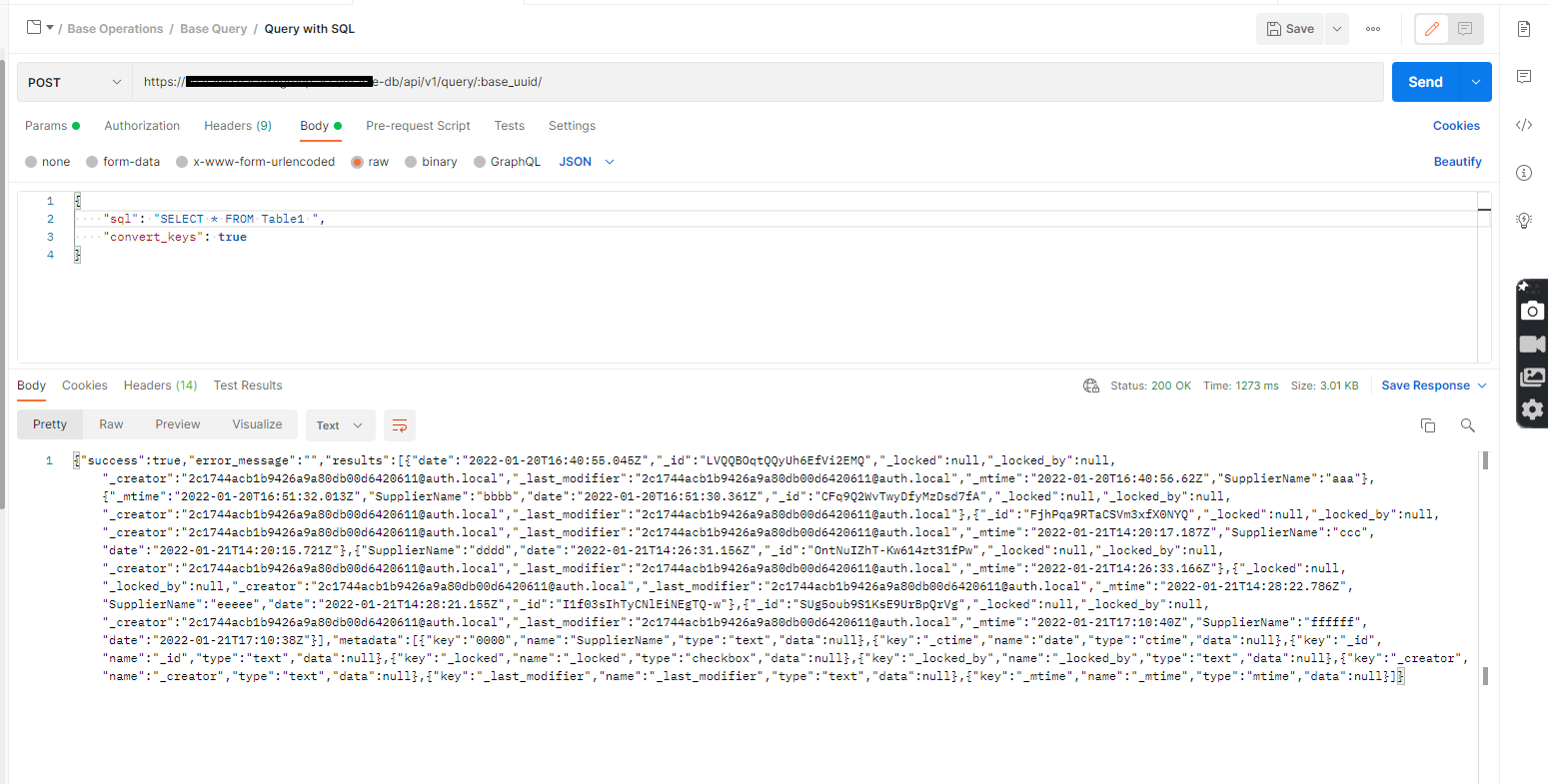

@MutedJam weird, i am not getting _ctime in my query.
Woah, that’s weird indeed but could be the reason for the behaviour you were seeing (and would explain why the query was working fine for me). Thanks so much for giving this a go @Benjamin123!

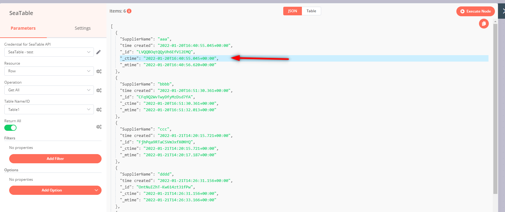

@MutedJam it is strange though, if i use n8n seatable node to get all information , it return _ctime though.

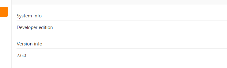

anyway i am using selfhosted seatable 2.6
