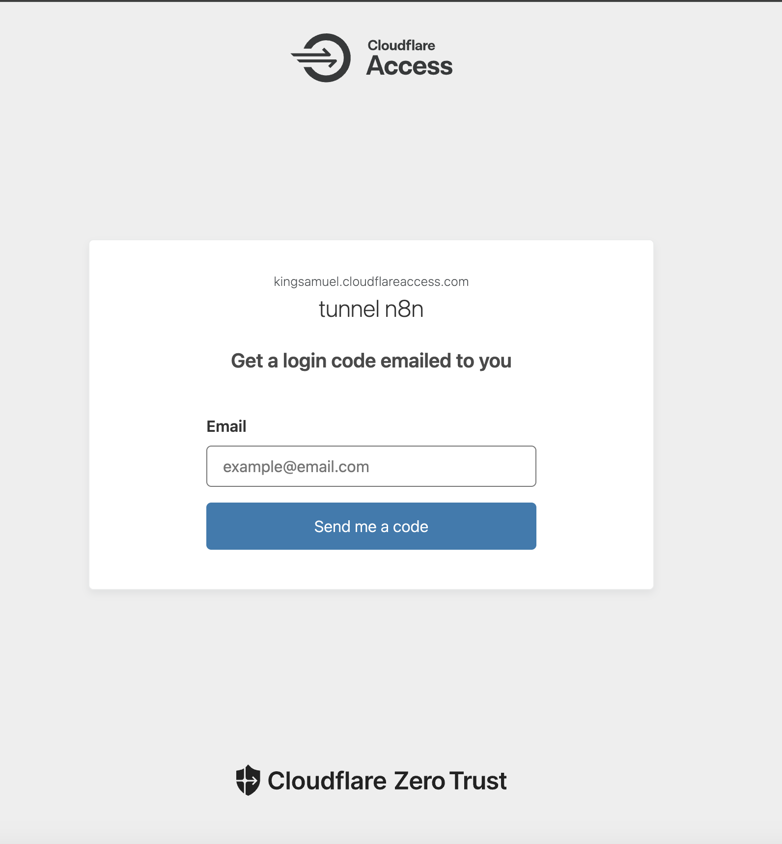

Big shout out to @TFSho & @King_Samuel_David . Here’s a video demonstrating the work you gentlemen contributed to.
:point_right: Video Tutorial
btw, if you want I can explain securing I briefly mentioned it here
using zerotrust, maybe another good content piece for you
oh this is gold! Thanks for sharing!
