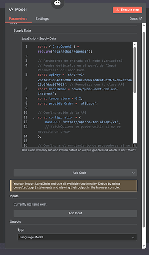

I found a temporary solution that works and meets the need, hoping that the n8n developers will support it. It is using the native n8n langchain node, which in a few words is the basis of all n8n.
(The data and including the API keys are test data, in the case of the API key it no longer exists in case you want to use it xddd)
in the code :
const { ChatOpenAI } = require(‘@langchain/openai’);
// Parámetros de entrada del nodo (Variables)
// Puedes definirlos en el panel de “Input Parameters” del nodo Code
const apiKey = ‘api_key_openrouter’; // Api key OpenRouter
const modelName = ‘qwen/qwen3-next-80b-a3b-instruct’; //name model of openrouter
const temperature = 0.2;
const providerOrder = ‘alibaba,deepinfra/bf16,parasail/bf16’; //provider to routing
// Configuración de la API
const configuration = {
baseURL: ‘ OpenRouter ,
// fetchOptions se puede omitir si no se necesita un proxy
// Configura el enrutamiento de proveedores si se ha especificado
const modelKwargs = {};
if (providerOrder) {
modelKwargs.provider = {
order: providerOrder.split(‘,’).map(provider => provider.trim()),
// Crea una instancia del modelo de chat
const chatModel = new ChatOpenAI({
apiKey: apiKey,
model: modelName,
temperature: temperature,
timeout: 60000,
maxRetries: 2,
configuration,
modelKwargs,
// Devuelve el modelo para que la cadena lo use
return chatModel;
see my last response in this post

Sorry if this is dumb question but how can i connect a code node as a model? I am trying to use this to power the ai agent node. Thanks, Doug
To answer my own question for others who might wander upon this. You use the Langchain Code node. It wont appear if you hit the + on the model selector on the AI Agent model selector. Just create the node first with the main + button. You have to choose the data not execute option for th e code block. Then you choose the output as a model. Put the code in above and it will work, but I had to fix all the apostraphies because the cut and paste changed them to stylized quotes not the coding quotes.
