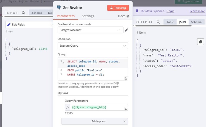

The Postgres node (named “Get Realtor”) executes the query SELECT telegram_id, name, status, access_code FROM public."Realtors" WHERE telegram_id = $1; successfully. When testing with an existing telegram_id (e.g., 12345), I can see in the Input panel of the next node that the Postgres node correctly returns the data, for example:
JSON[ { "telegram_id": 12345, "name": "Test Realtor", "status": "active", "access_code": "testcode123" } ]

Weird,
Try to pin the data on the output of postgres: [ { "telegram_id": 12345, "name": "Test Realtor", "status": "active", "access_code": "testcode123" } ]
it should work as mine

I’m just not sure how the DB actually outputs the data, I have just pinned what you have stated as JSON. this might have been an incorrect assumption.
I have pinned this data but unfortunately it is still there invalid syntax

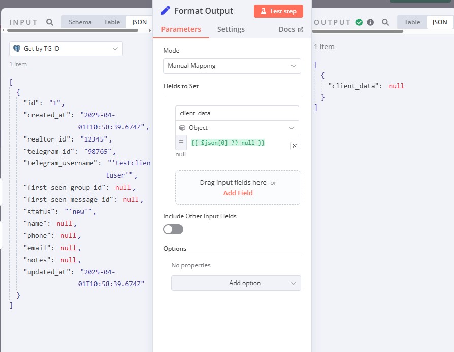

I made 3 subprocesses. In each of them, the correct data comes to the “Format Output” block. But the output is null . I can’t figure out what the reason is…

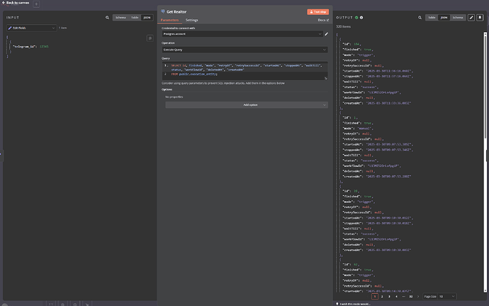

So i made a test connecting to the n8n postgresql database to simulate the real data format.
All my tests come back working, the way i described before:

but I don’t understand how to set up the same logic for the other two nodes…
