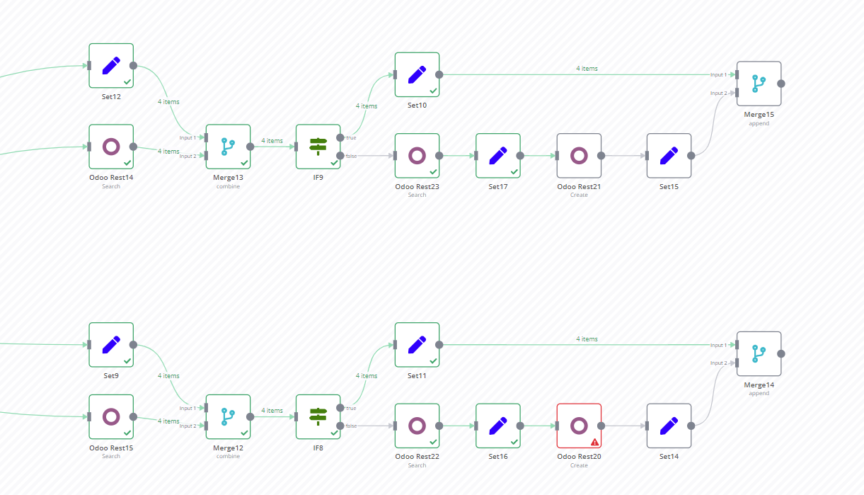

Hi, i found this post over the commit bug fix from github.
I have also the problem with chek if empty but i am on 0.205.0
tryed your work around with .toString() but this doesnt work.
