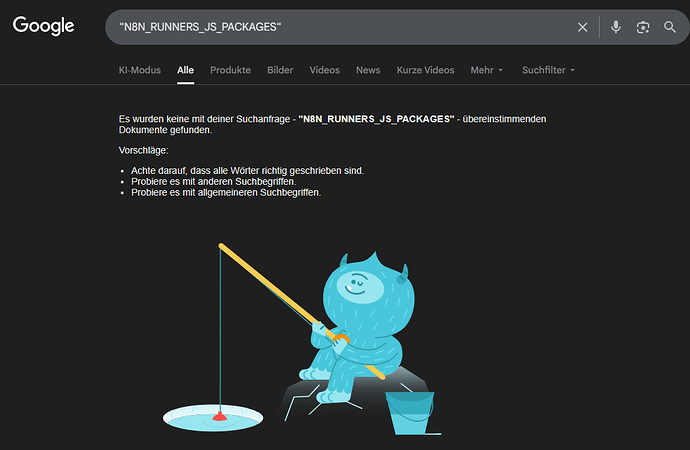

That env variable does not exist anywhere in any n8n repository. Did you vibe-imagine it with AI?
