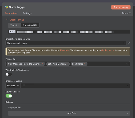

If you are talking about the Event Subsription
You can just use n8n slack trigger’s production url. It will solve the challenge parameter automatically.
