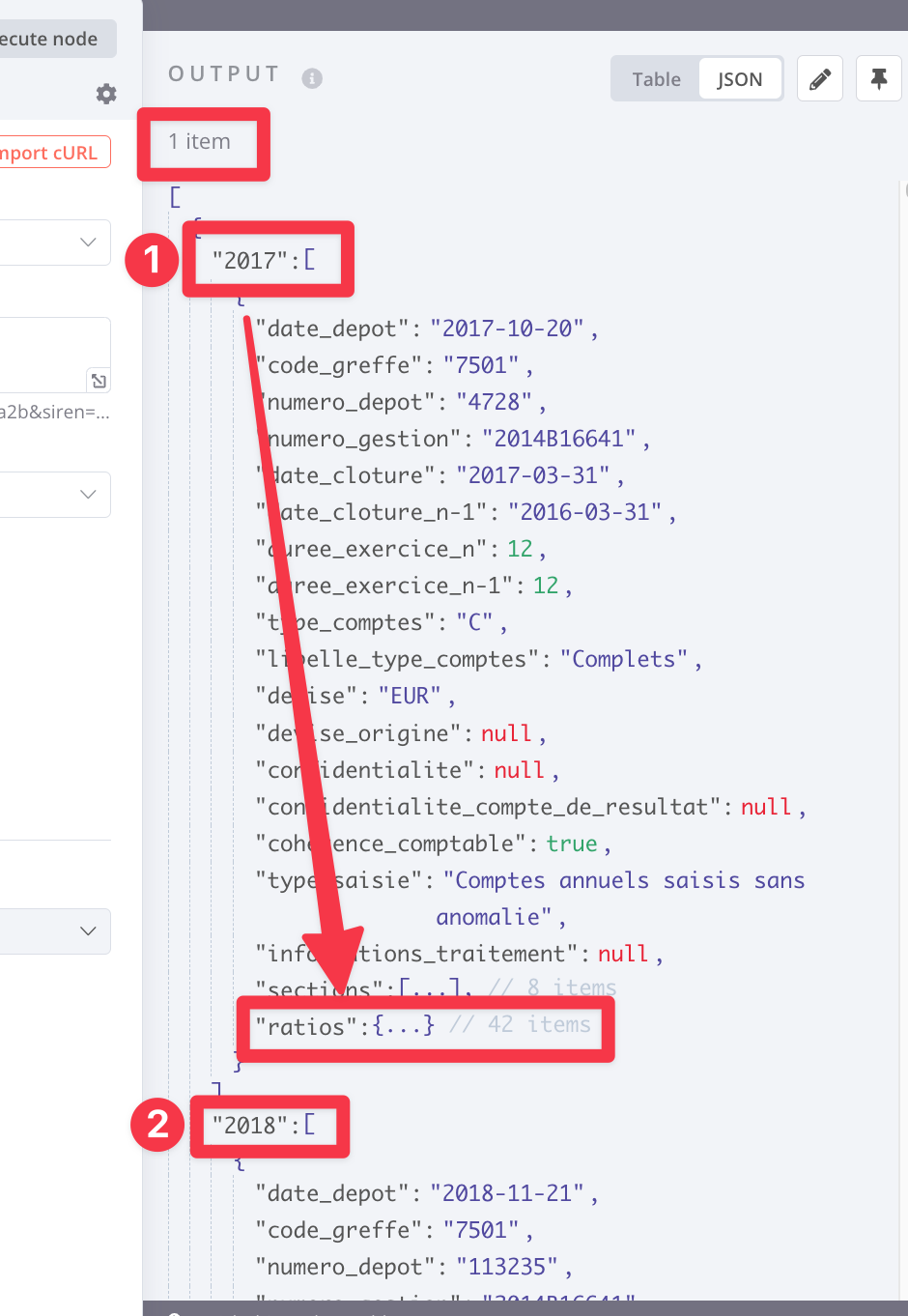

I am struggling with a JSON result that I get from an API: it gives me an output with several columns.
Here is a screenshot :
What I am trying to achieve, is to get ratios (42 items) per year.
Here is another screenshot :
Is there any solution ?

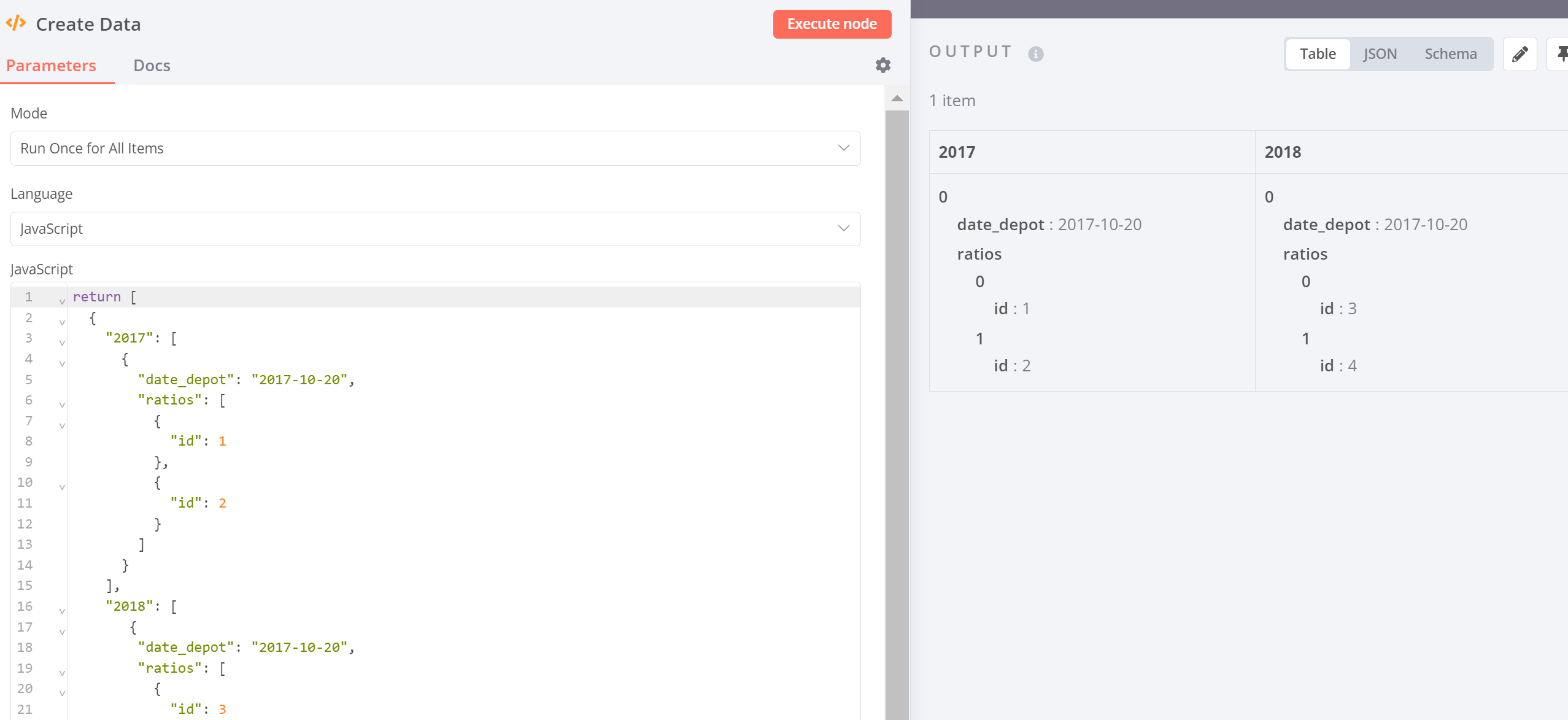

Hey @RomainMaltrud,
that json body is kind of strage. Espacially the way the arrays are defined. Thatswhy I think it is the best to use the code node to achieve what you want.
I created some testdata which looks like your provided one.
This code node parses your data to entries like this:
 "year": "2017",
 "ratios": [
    "id": 1
    "id": 2
This is the Code:
const returnList = [];
for (const item of $input.all()) {
  const years = Object.keys(item.json);
  returnList.push(years.map(year => {
   const ratios = item.json[year][0].ratios;
    return {
      'year': year,
      'ratios': ratios
  item.json.test = returnList
return returnList[0];
If I copied your json data correctly, this code should just work plug and play.
Cheers.
