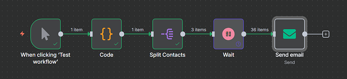

I am trying to use the Split Out node to perform an action: call a subprocess. For the sake of simplicity, I’ll try and send emails.
I want each of these emails to be sent at a specific time. So I included a Wait node which, again for the purpose of this post, takes the item ID value, multiplies it by 5 (seconds) and then send the Email.
What is the error?
The emails are never sent. The Wait node loops on itself by multiplies of 3 (number of items) until… well, I waited until it reached 36 but that did take some time.
The real version
The real version has a “Scheduler” Code node that generates 2 (or sometimes 3 – but the version pasted here has hardcoded test values) “delaySeconds” values, that are used for the Wait function. But what happens, is that all 2 (or 3) emails are sent at once, when the first one executes.
The only way I managed to make this work is to have 3 separate Wait nodes, one per item… But I feel it’s not the way n8n is supposed to work :sweat_smile:
In this case however, I do get emails at 5 sec, +2mn and also at +3mn (with a modified test Scheduler).
Sooo… if anyone can help me explain what really is happening, that’d be great!

Hey @Florent14 hope all is well. Welcome to the community.
This is because your expression is wrong.
It should be:
{{ 5 * ($json.id - 1) }}
otherwise you are sending text to the number field
Silly me :sweat_smile:
Thanks a lot, this does work now.
Still, I wonder why I can’t get the “real” version to work.
If you pin some data for me to look at for the Code node, I can try to run an see what is what

This is what I would do. I would split this into two workflows. Attaching both on a single canvas, please separate into two and point the main one to the second one in the last node:
Wow, this worked…
I’m non-plussed. I’m not sure why shifting the Wait node in a subprocess works, whereas having it straight after the Split Out node doesn’t.
It tends to mean the data structure that is outputed by the Code node is correct, so…
Anyway, since all I wanted to do was exactly to activate a subprocess, I’ve marked your proposition as a solution.
