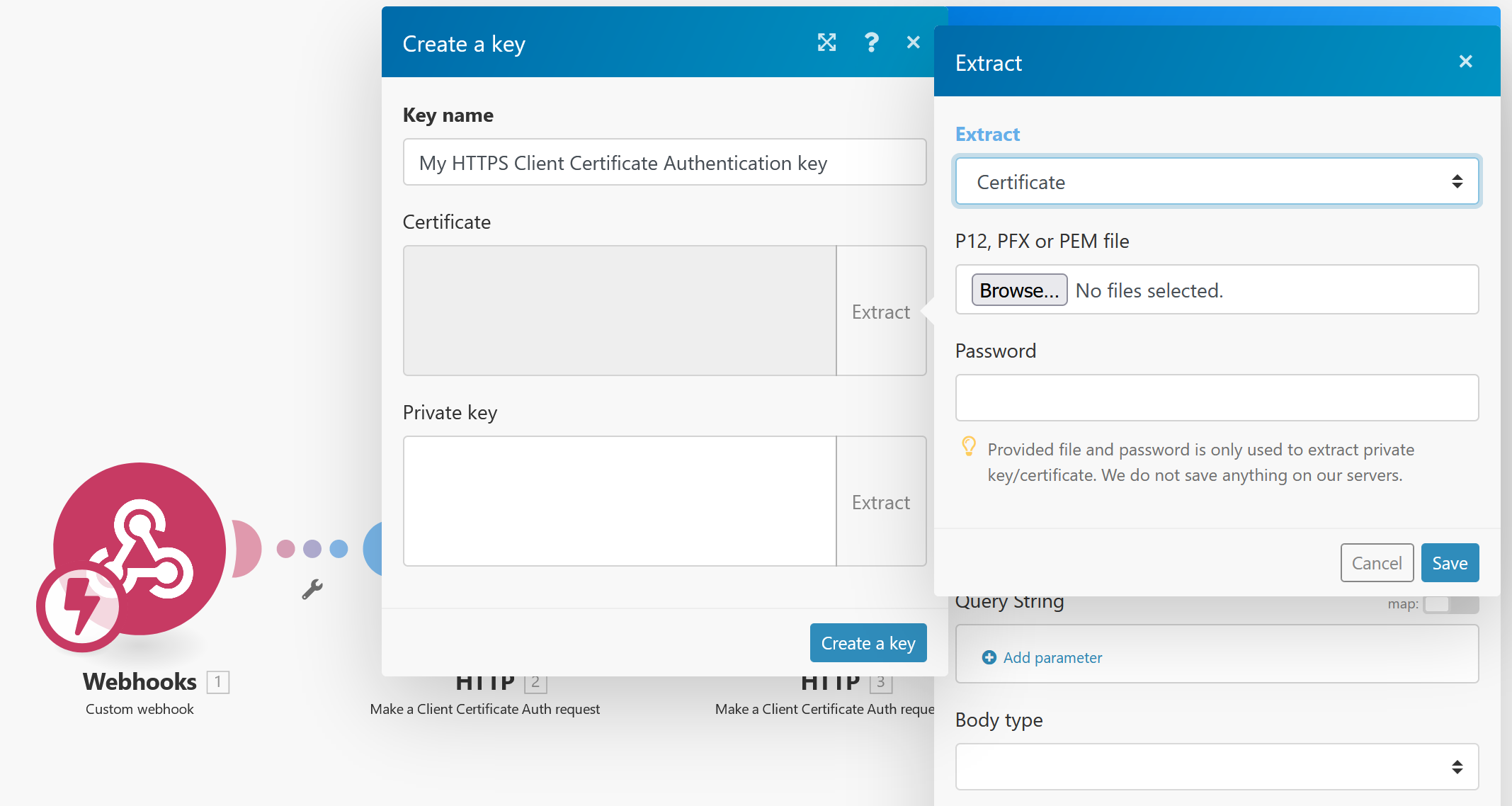

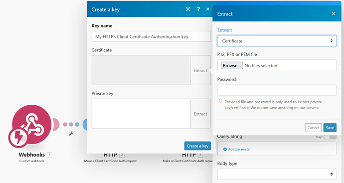

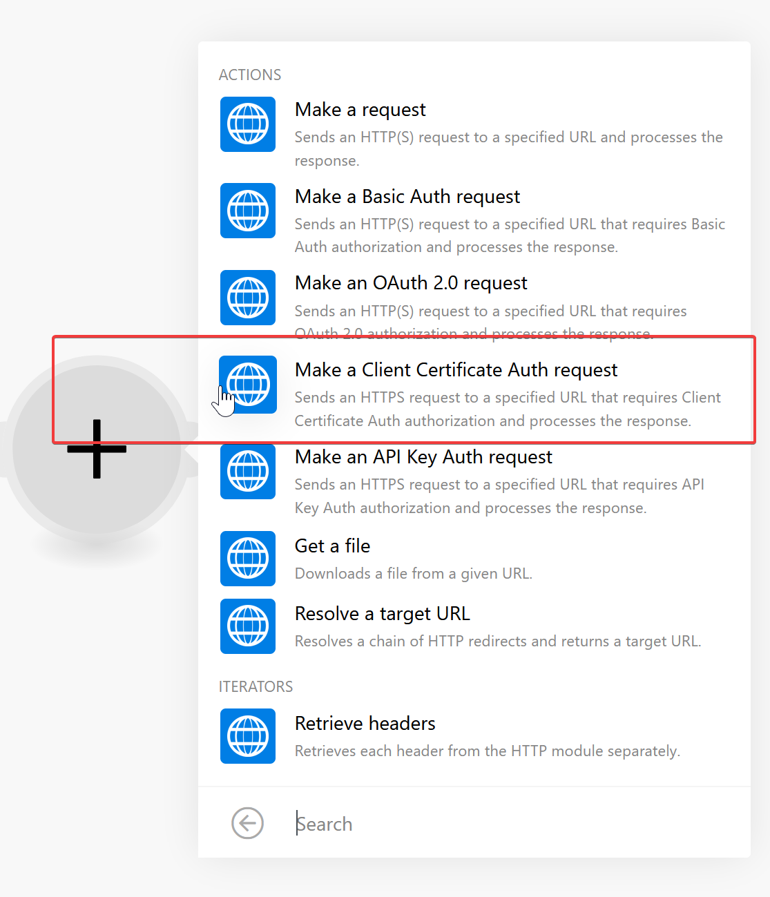

We think this feature will be very interesting also for n8n cloud as there are other solutions that already have it. aka make.com (integromat.com). Examples below.
It is interesting the way the handle the cert and key files. They have a helper, that extracts the key which is what actually gets saved in the credentials module.
