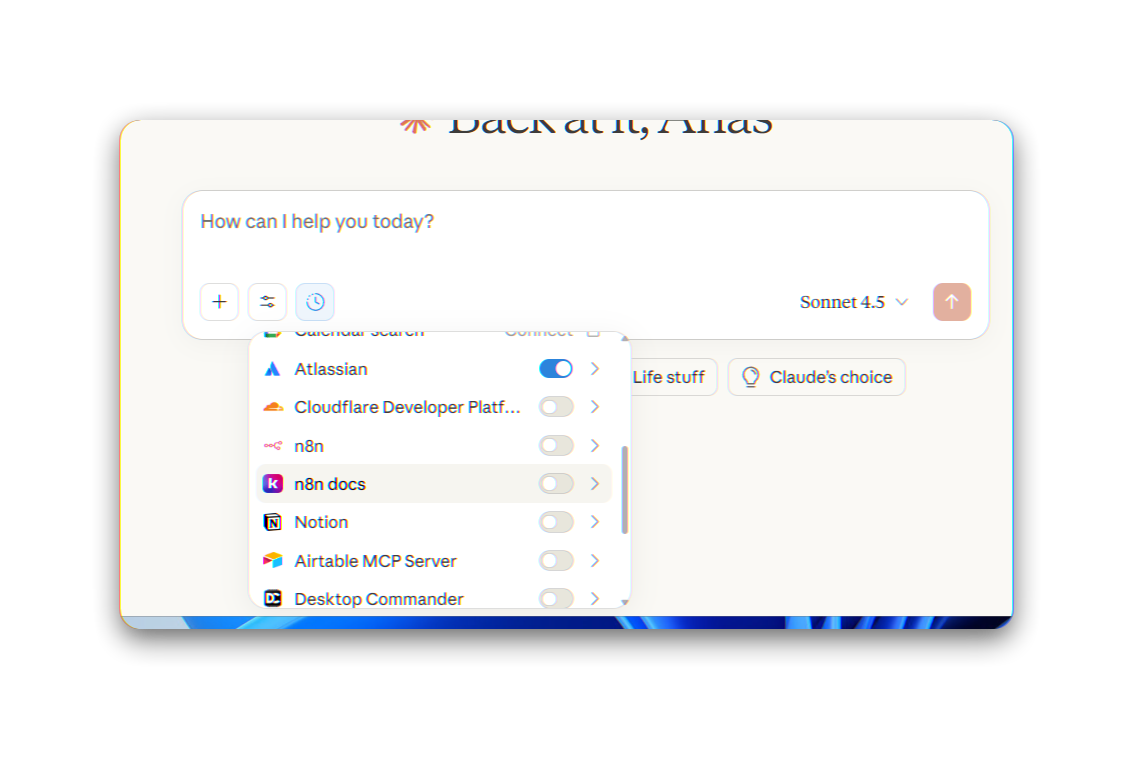

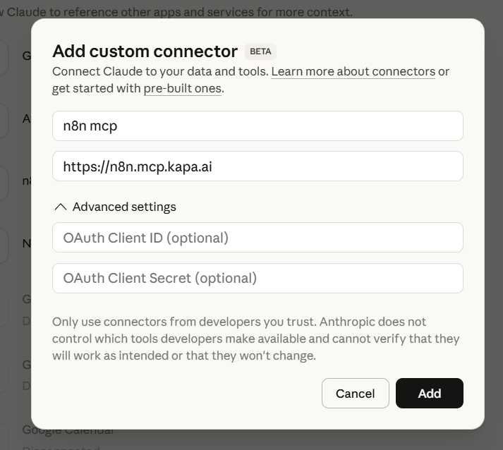

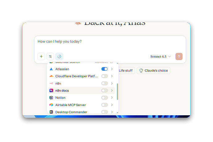

n8n is using an agent service called “Kapa” and their MCP service for n8n is available at https://n8n.mcp.kapa.ai/. You just link that URL and auth your kapa account (just use google auth with free plan), and you’ll get an MCP for the n8n docs, as shown in the image, which can help any AI agent using the latest n8n documentation.

or using GUI like Claude Connector:

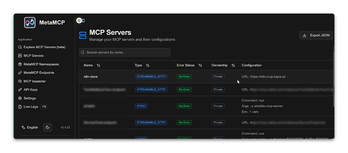

Pro tip: We use MetaMCP to manage MCP servers into one endpoint. and i have deployed n8n mcp server there and it worked too:
i am going to use Metamcp to make n8n docs search available as action in ChatGPT plugin n8n assistant with this solution and it’s free like n8n selfhosted, you can do same if you’re looking for n8n docs up-to-date and easy to manage with client resources.
