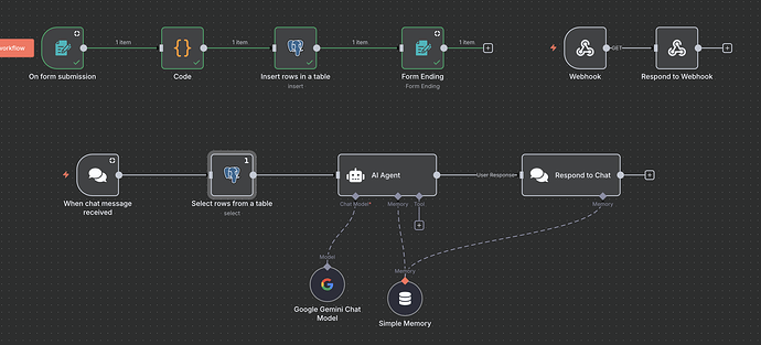

Right now it looks like this:

Now, from the screenshot you sent , since you’re following the mentioned workaround, something is still missing which is (the HTML generation)
in that HTML template you’ll need to set:
  • webhookUrl (this is the chat URL)
  • metadata (you can set it manually or automatically)
also I’ve updated the lib links and also enabled automatic reading of the meta data.
You can use this workflow directly:
Note (to make the logic clear):
At the end of the form, you’ll send the user the webhook URL (which will have the query parameters) that is generating the HTML page that contain the chat that will triggered and you will find the parameters under the metadata..
Hope this helps, let me know if it’s not clear.

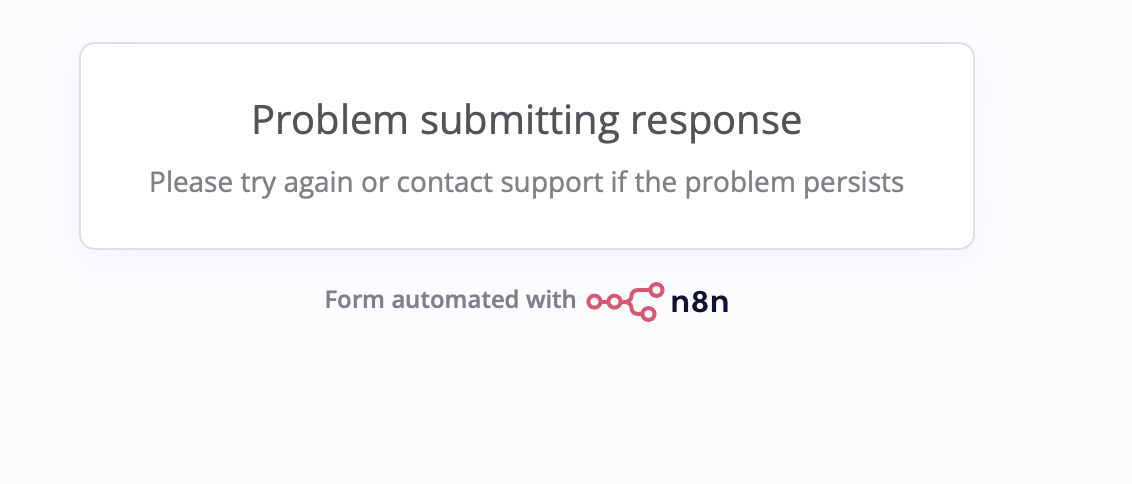

Thanks for this–helpful to see your changes. I have tried your link and it fails for me with this error:

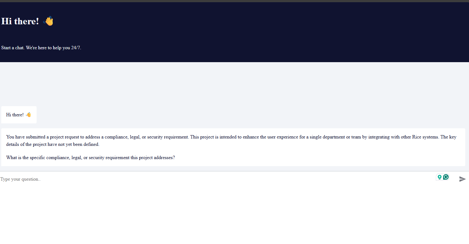

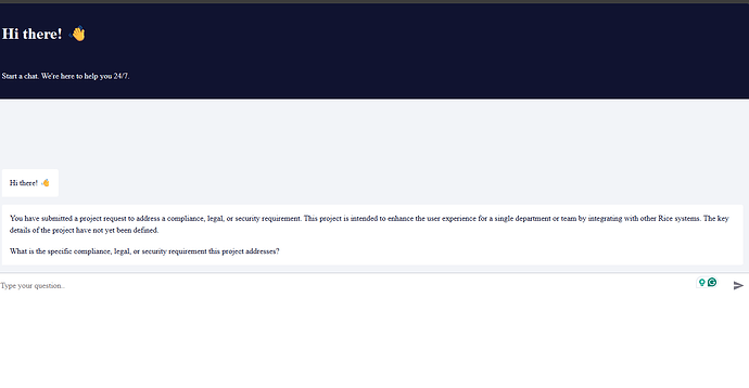

That’s why I shared a live link, it’s actually working with the same workflow I shared above, After you submit the form, you’re automatically redirected to the chat like this
Yeah, this is really odd. I don’t get the same “redirect” message when I run it on my own machine, it just jumps into a chat, minus the “Type your question” prompt. I don’t even have that portion of the page showing up. I literally just copied your code and changed the URLs, I didn’t change anything else about the chat interaction, so not sure what’s causing the issue. Any ideas?
What do you get exactly?
Here is the chat from your last entry:
Can you try opening the link in an incognito window?

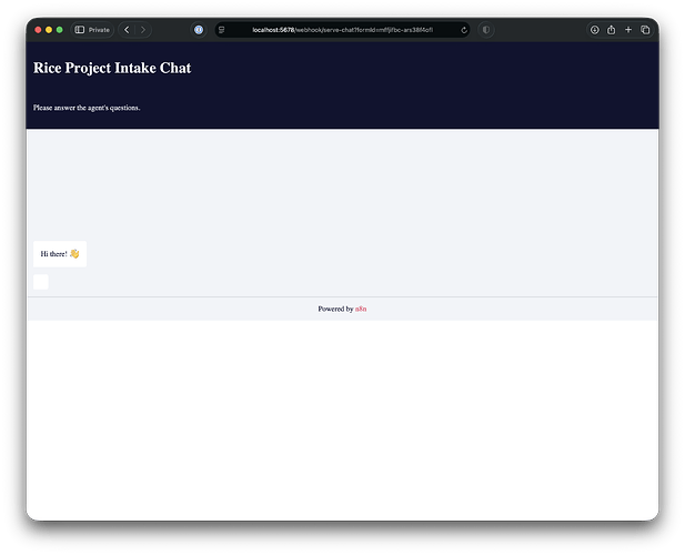

Oddly, I don’t get the “redirecting” message when running on my own box, it just goes straight from the form to the chat window. Perhaps that’s just due to network latency, which is non-existent in my case.

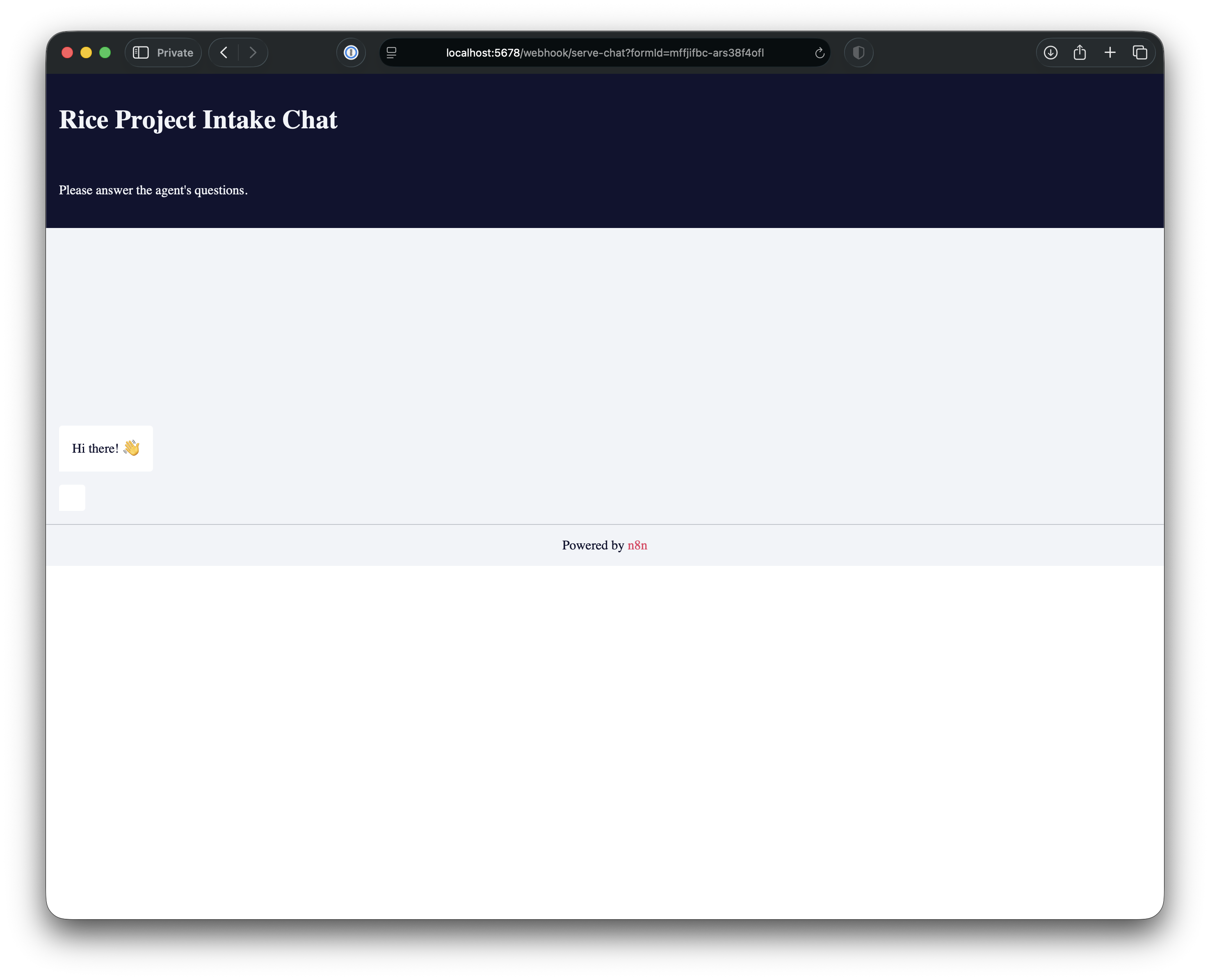

Anyway, my chat window looks like this when run using the production URLs all around (none are https in my case):
Yes, I updated some of the text fields, but I left the chat workflow you provided the same. When I check the Executions tab to look at the production run, it has logged the Form workflow, and the Webhook workflow, but NOT the chat workflow, so I can’t look at that to see what’s happening. I’ve double-checked the URLs and all is correct, so I’m starting to wonder if the lack of SSL is a contributing factor, as a bunch of the chat interface is simply not rendering.
