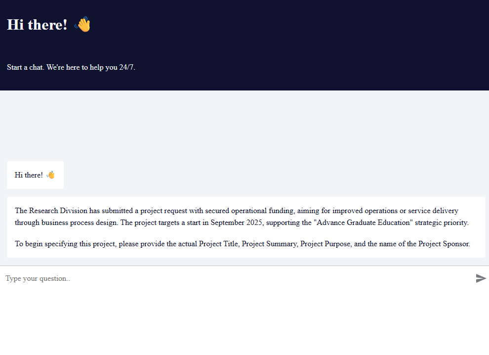

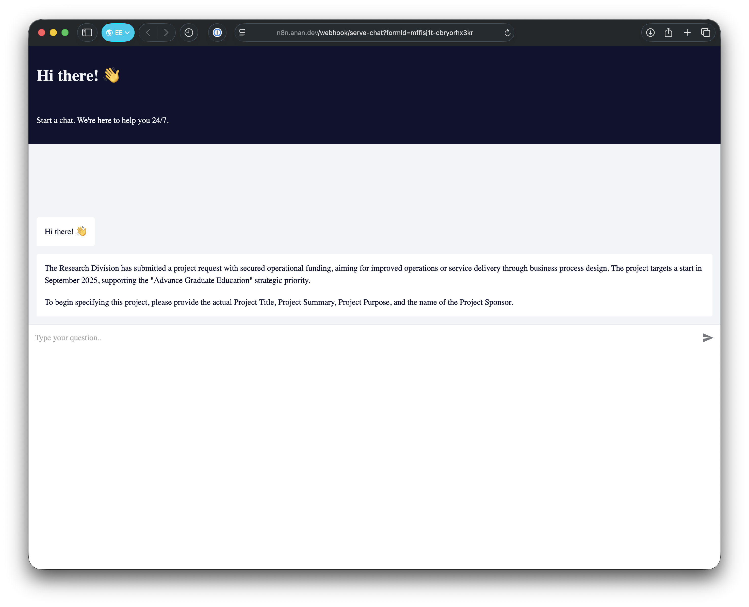

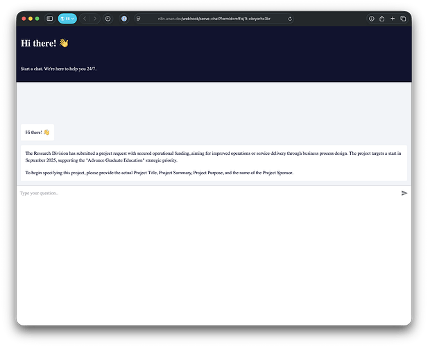

Please try opening this:
and tell me what you get, If it works on your side, then it means something is not correct in the workflow you’re working on.
Also, regarding this:
At this stage, there are no logs in the chat trigger yet until the user replies.
Here’s what I get from the workflow you’re running on your side:
The full interface is there. Again, I didn’t change any of the chat part of the workflow you created–I just updated URLs in the rest of the app so it would run correctly on my machine. It’s clearly not serving up the same HTML for some reason.

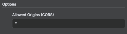

Since you’re working on localhost, can you try adding the CORS option in the chat trigger?

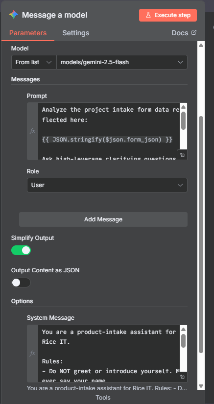

Also, did you add the new AiOutput column to the database?

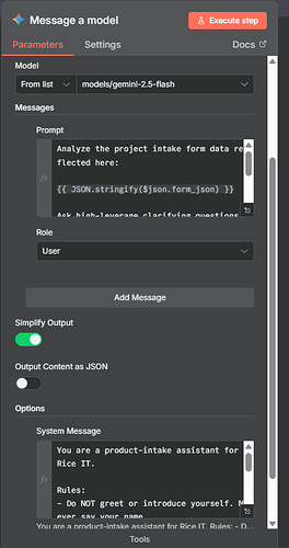

Finally, please double-check the workflow I shared, I didn’t change anything except the AI model to “flash 2.5.” Otherwise, it’s the same as live.
I’ve added that CORS setting of *, and there’s no change to the chat page.

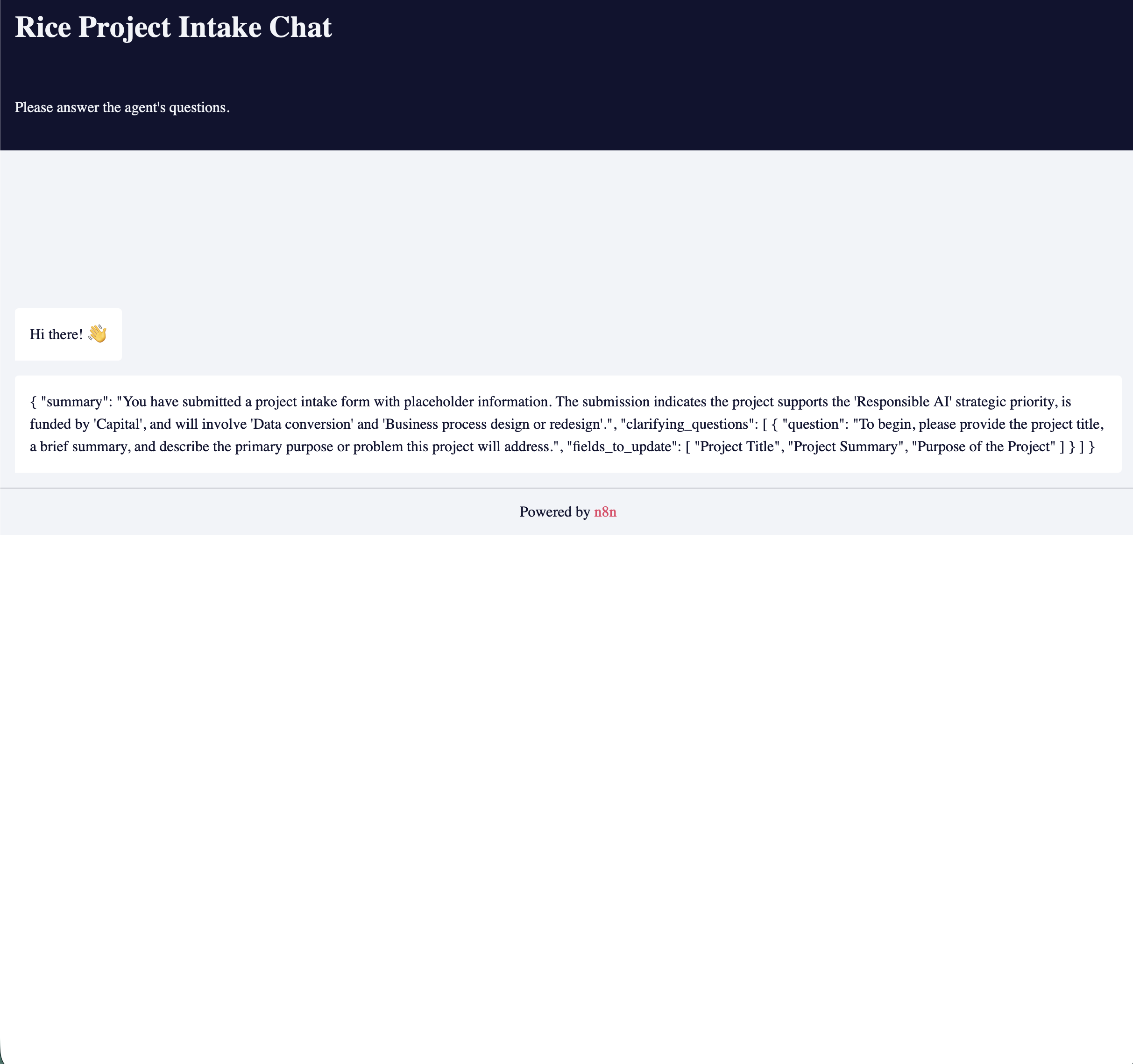

Okay, that’s a good catch–I already had an unused text column in the DB and also put the same JSON in there, so I just used that column instead for the HTML. Now that text is showing up in the form, though I don’t know why the formatting doesn’t match yours.
I still don’t get a text entry field for the chat. I really don’t get what else could be happening here.

Now, to get back to the prompt info you had inserted into the initial chat window, I inserted the same data you did into a different text field in the DB, using the same syntax, and retrieved it into the HTML using the same syntax, also. Yours is formatted nicely and mine is not, which I don’t understand.

The formatting is just the AI output that’s saved into the database column AiOutput with type text
As you can see here:
              	initialMessages: [
                  'Hi there! 👋',
                  {{ $json.AiOutput.toJsonString() }}
The code takes the value from the database and converts it to a string inside the array.
I’d forget about any manual or test entries and just try fresh again.
The AI output in the database should be plain text, like this:
