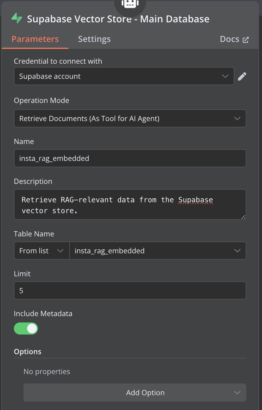

I’ve run into a bizarre issue with the Supabase Vector Store node in n8n that I’m hoping someone can help me understand.
The Problem: I’ve configured my Vector Store node to query a table called insta_rag_embedded, but when I run the workflow, it’s actually querying a completely different table called vector_embeddings. I’ve triple-checked my configuration, and it’s definitely set to insta_rag_embedded.
What I’ve Confirmed:
  • The UI clearly shows the table name is set to insta_rag_embedded
  • The Operation Mode is set to “Retrieve Documents”
  • The results being returned match records from vector_embeddings (confirmed by directly querying the database)
  • Both tables have similar schemas (id, content, embedding, metadata) but different content
What I’m searching for: A query like “Can I rent a surfboard at Villa —?” returns results that contain content about surfboard rentals at — but this content is in the vector_embeddings table, not in my configured insta_rag_embedded table.

Hey @Maxime_Prn Welcome to the community :wave:
One idea would be to check the contents of the SQL function match_documents which is what the Supabase vector store tool calls by default.
If you’ve followed the Supabase Langchain quickstart, you can see this match_documents function has the table name “documents” hardcoded as part of its query. My guess is if you have something similar, this could possibly explain the weird behaviour you’re seeing.
Right on point!
My match_document function was defined as follow:
SELECT
    id,
    content,
    metadata,
    1 - (embedding <=> query_embedding) AS similarity
FROM vector_embeddings
ORDER BY embedding <=> query_embedding
LIMIT match_count;
That’s why it was only looking through my “vector_embeddings” table.
Thanks Jim!
