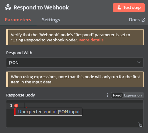

hello @marcinxp
You haven’t specified the JSON body for the Respond to Webhook node.

This doesn’t work. I’ve checked it and put in ‘Respond to Webhook’ (checked also with ‘no data’ and ‘all incoming events’.
{{ $json.output }}
The same result, the webhook is still listening (waiting for trigger event). Maybe this is something related to my docker n8n set up on vm google cloud. Why the same parameters working in the Make webhook node?
