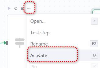

Works for me as expected when the Switch node is activated.
If this resolves your issue, please mark this post as a :white_check_mark: Solution.
Thanks man, should´ve seen that :sweat_smile:
Happens to the best of us.
