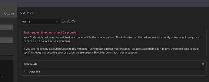

I’ve been getting “Task request timed out after 60 seconds” errors on Code nodes for over a week.
Instance: aiplug.app.n8n.cloud
Plan: Paid
Running via: n8n Cloud
The error says the task runner is “down, not ready, or at capacity.”
The n8n AI confirmed this is NOT a code issue - it’s infrastructure. My code is simple (extracting unique IDs from a Map).

    I found threads about N8N_RUNNERS_TASK_REQUEST_TIMEOUT but I’m on Cloud and can’t set environment variables.
    Can someone help or restart my instance?

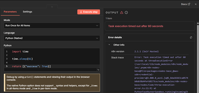

I have the same issue since updating to 2.0.2 at a self-hosted instance. I thought it relates to the newly activated task runners but if there are other with same problems and 1.x versions it must be a different problem
I can confirm the same issue with self-hosted task runner as well,

For those having problems with code node when upgrading from v1 to v2 in self hosted versions, it is important to consider that there is a breaking change in v2: you should enable task runners and configure it correctly in docker compose file and in n8n-task-runners.json. If you plan to use Python, it is necessary to use external task runners and you will need to create a container for the task runners as well. It could be helpful to check for the container logs.
I have version 2.2.4 and finally managed to get the code nodes to work.

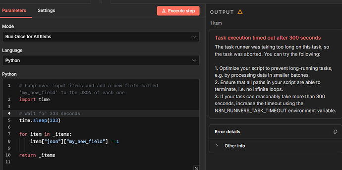

based on my case, I can confirm this is working without issues in V2.5 finally :slight_smile:
Edit:
note that my N8N_RUNNERS_TASK_TIMEOUT added in both n8n main & runner env vars,
after setting it to 300 and testing, it correctly stops when the code takes longer than expected,
I also believe this is a new error message, and it is well detailed:
