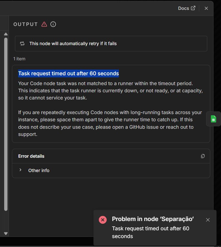

My n8n flows aren’t working every time they reach the code node. At first, I thought it was just one code node, but I checked the others and it’s happening in all of them that use code as a node. "Task request timed out after 60 seconds
", an error that never appeared before, and I don’t know how to solve it or why this is happening.
Information on your n8n:
  • n8n version: 2.4.6
  • Running n8n via n8n cloud):
Is this happening to anyone else? I need help as soon as possible to get the processes working again.

There’s a known n8n Cloud problem where all Code nodes start failing with
“Task request timed out after 60 seconds.”
It happens when the workspace task runner gets stuck or unhealthy, so every Code node times out even with simple code. Here some link that i found of some other users which experienced the same and it was fixed after restarting or updating the workspace:
http://community.n8n.io/t/n8n-cloud-2-0-3-code-nodes-intermittently-fail-with-task-request-timed-out-after-60-seconds/251121
Codes nodes are stuck
By reading your desc. you’re on n8n Cloud and you can’t fix the runner manually. Do this:
  1. Restart the workspace (most important)
    Cloud Dashboard → Admin Dashboard → Manage → Restart workspace (some reference solutions)
    http://community.n8n.io/t/code-node-fails-to-get-assigned-executed-every-time/260158
    http://community.n8n.io/t/webhook-stays-on-queued-in-the-cloud/214185
  2. Update n8n
    You’re on 2.4.6, so upgrade to the latest version from the same panel. Many users reported the timeout disappeared after updating:
    http://community.n8n.io/t/javascript-code-node-just-times-out/213690
So it’s not your workflow, it’s the Cloud runner. Restart first, then update, and it should be resolved.

Just to reinforce what @Deepankar shared — this is definitely a known issue with the n8n Cloud task runner getting into a stuck state. The 60-second timeout on Code nodes happens even with simple code when the runner is unhealthy.
**Quick fix priority:**
1. **Restart your workspace** (Cloud Dashboard → Admin Dashboard → Manage → Restart) — this fixes it 90% of the time
2. **Upgrade to latest** (you’re on 2.4.6, latest stable is 2.6.3) — several task runner fixes landed in recent versions
