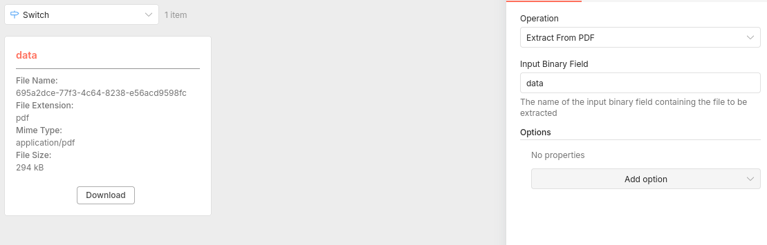

  1. you need the input binary field in the Extract nodes to data

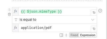

  2. In the Switch node check for mimeType instead of extension (This is what we use in the code node and is safer than using the extension)
