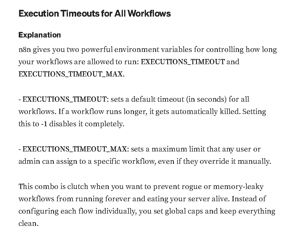

hey @Rex_Mundi check these out they will help.
https://onurbolaca.medium.com/n8n-self-hosting-what-the-docs-can-teach-part-1-96b25230cb99
from medium article
and for n8n cloud these are timeout for cloud:
That’s another thing. Workflow limit could be e.g. 2 hours, but “OpenAI” nodes like “Message a Model” will timeout after 5 minutes

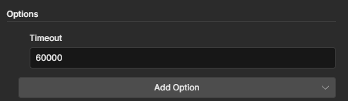

For some other nodes e.g. “OpenAI Chat Model” you can choose timeout in Options and set whatever you need to, but not for this particular node

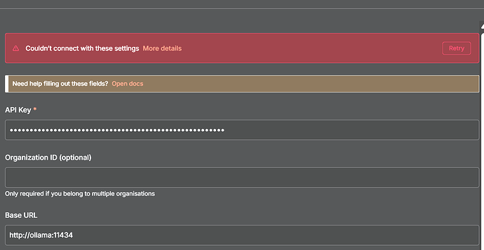

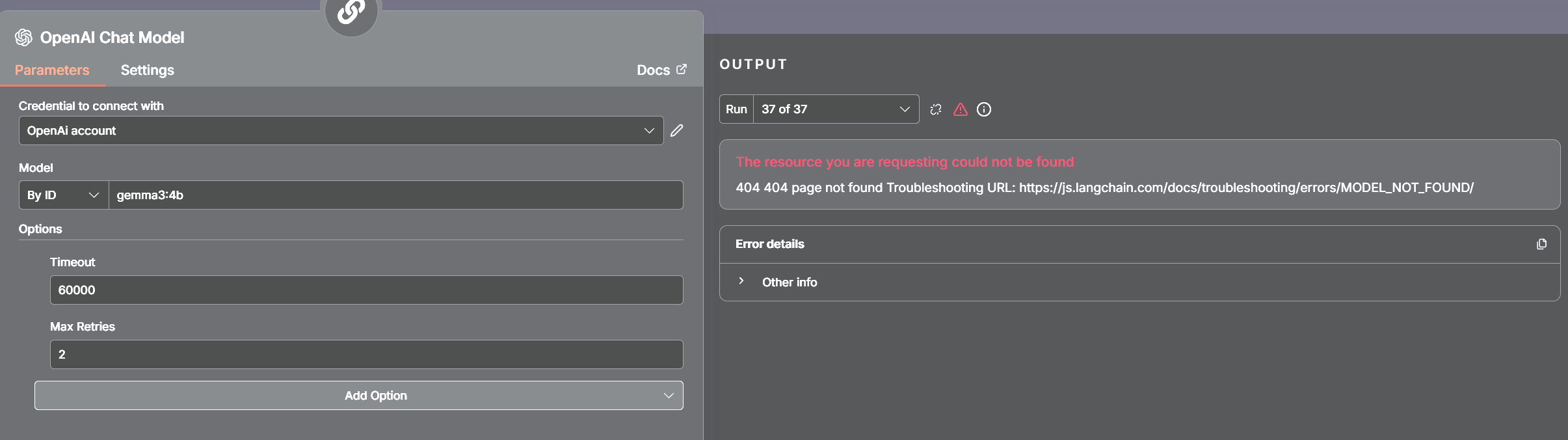

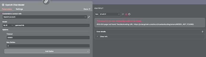

I have tried it just now but the credentials cant be set to ollama
what is the base url that you set?
The resource you are requesting could not be found
404 404 page not found Troubleshooting URL: LangChain overview - Docs by LangChain

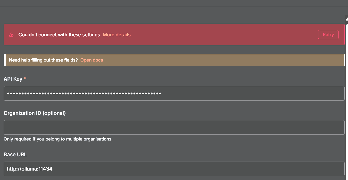

i copied url and api key
even with adding /v1 ?
Where to write /v1 ?
here:
Also, make sure the URL is actually working and reachable.

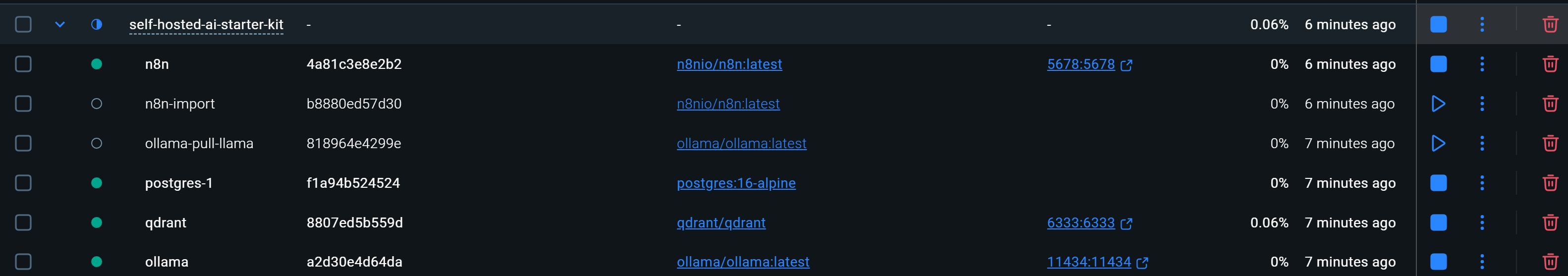

on http://localhost:11437/ its ERR_CONNECTION_REFUSED idk. ollama runs with docker
