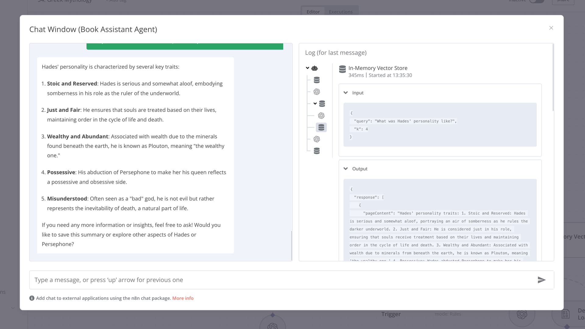

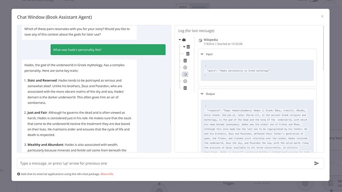

I cooked up this example workflow to hopefully help you debug your tool problem.
