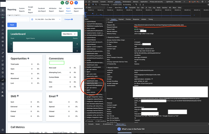

Trying to access GHL "Agent Report" via hidden API's but getting IAM Service issues
Good Afternoon,
Just wondered if anyone had any experience with calling hidden api’s on GHL?
I am trying to get the “Agent Report” from GHL for a client for each individual sub account.
For example the end point
https://backend.leadconnectorhq.com/reporting/opportunities/leaderboard-stats
I am setting this up and getting 401 errors relating to IAM config.
Is this accessible via n8n or not?

It would be private then as it was found in the console.
Can you demo me where exactly? What was the root url you used to discover the endpoint?
My recommendation is finding it again, copying the request as CURL, pasting into a terminal and running (if on linux/mac) the curl command to see if it functions. Then slowly start removing things to see what is required. Typically special headers and cookies are required.
Then you can investigate the page to see where those are generated (if possible). Sometimes they are short lived or long lived, so you could also create a playwright script to capture the headers and cookies and then send to your scenario to use them.

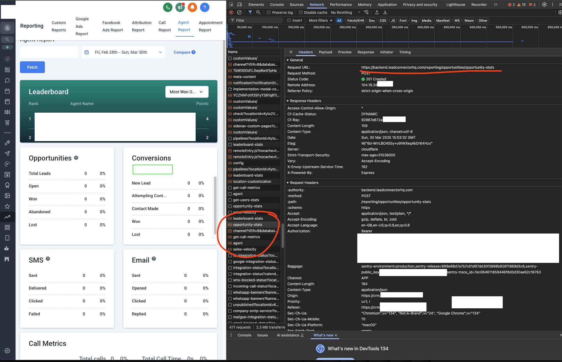

This is the screenshot of where I got the details from.
