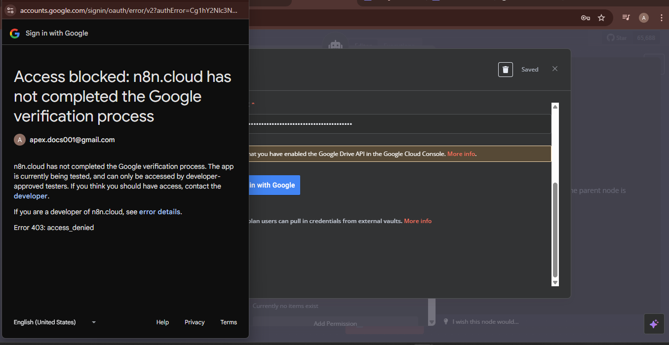

Unable to connect google drive to n8n. Below is the error I get
Log back into your Google Cloud Console and under the Audience setup for the Google Drive API, you’ll see “Test users”, click “Add users” and add your email. Re-try setting up the connection and it should now present you with a warning where you could press continue.
Hey I faced the same issue, but later realised i missed the important step that we have to publish our app after configuring OAuth consent screen.
