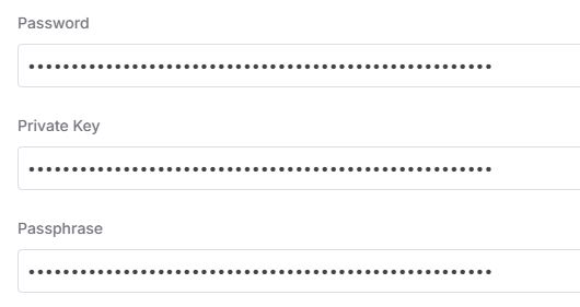

I was having the same issue trying to connect with user and password.
The Credentials window automatically fills the fields for the Private Key and the Passphrase with dots, even if nothing was written in them.
Trying everything, I deleted the content of both fields, and the connection worked immediately.
