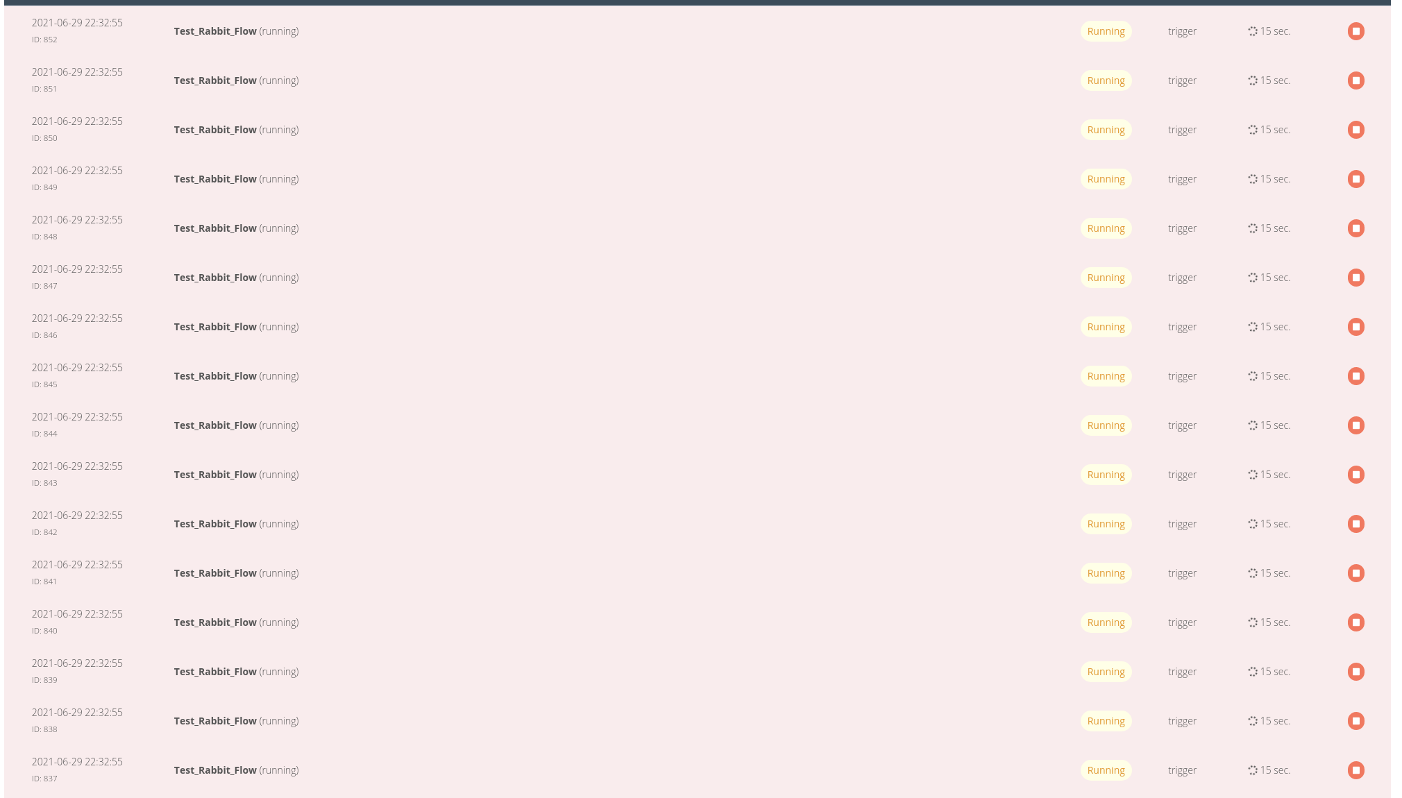

I set up a little workflow:
WorkFlow
I added a simple time loop to simulate a 5-second run and left it off.
Put about 30 messages in the queue.
I started the flow, and what do I see?
I see 30 floo running, even though there’s only one listener in the rebbit.
How?
No new messages should be accepted until the current ones are handled in success or error.
This leads to a large uncontrollable load on the server and high LA.
