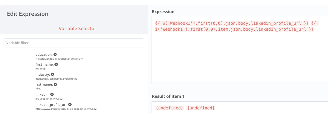

I tried your fix with no joy. Screen shows that there is data for linked_profile_url but still getting undefined. I have 2 expressions in there to test different options.
I get the feeling we are missing something obvious :thinking:

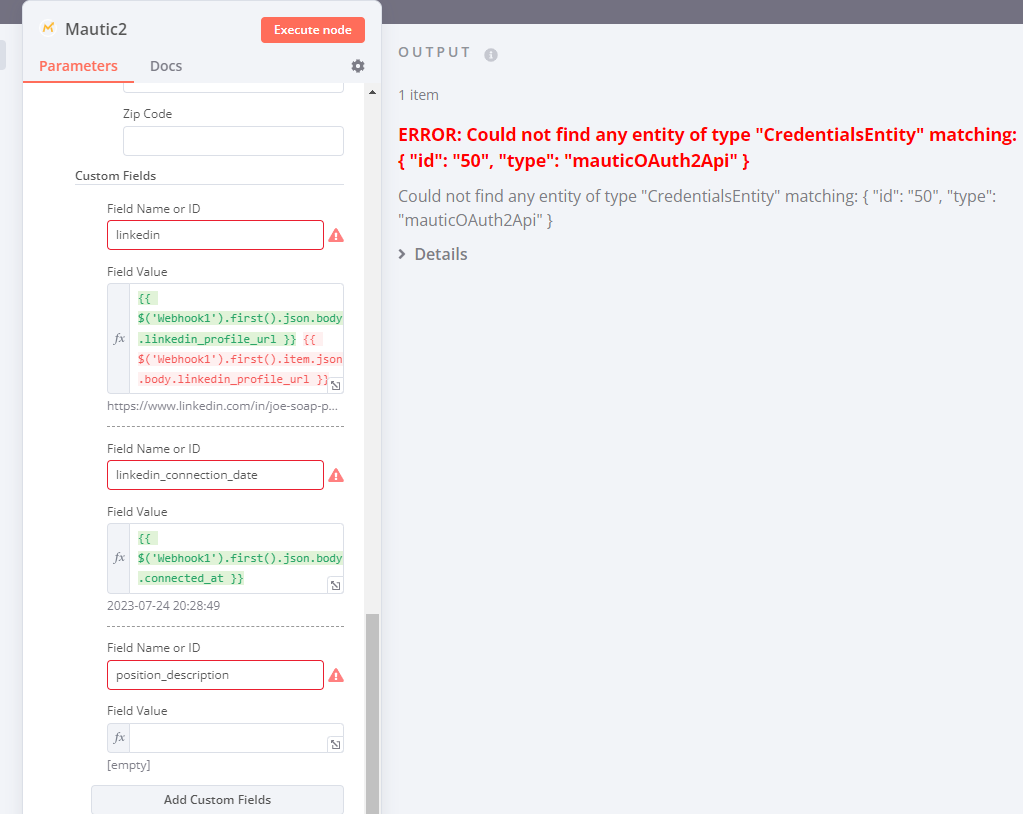

for me it is working @Robm What version are u running? 1.0.5?
of course I do not have credentials set so it is complaining about that and I also noticed some of the fields arent there but those are correct as well.
this isnt working though
need to do $input.first().body.title here
