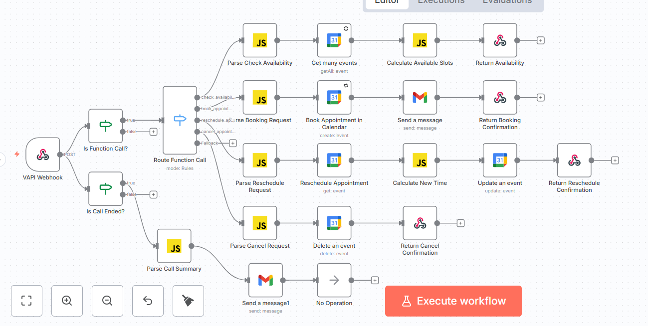

Thanks for your quick response. This is what I have going on. My bad but I have zero coding skills and don’t know haow to share it but here’s a screenshot of the workflow. I can definitely screenshot every node if it was necesary. thnak you.

Hi. Is this using the prod webhook while the workflow is live? Method, GET or POST?
The first webhook is set to post using ‘respond to webhook node’
n8n Workflow json
Appreciate your time and help. thank you.
No worries man. It should be on prod if you’re testing. is it?
Yes the workflow is active and the link at vapi server is the production link.
Did you set the environment variable WEBHOOK_URL in your .env file or docker compose?
I am using the n8n Cloud version, not self-hosting. I do not have access to a .env file or Docker configuration. I am using the Production URL provided directly inside the Webhook node.
Ok then…
The simplest way to check if your webhook is ‘alive’, just need a cURL request.
You can use postman or a CLI .
Your n8n webhook trigger is publicly since sent a curl request and got a 200 response with the headers specific to your url.
It means is a misconfigurations on the VAPI side.
