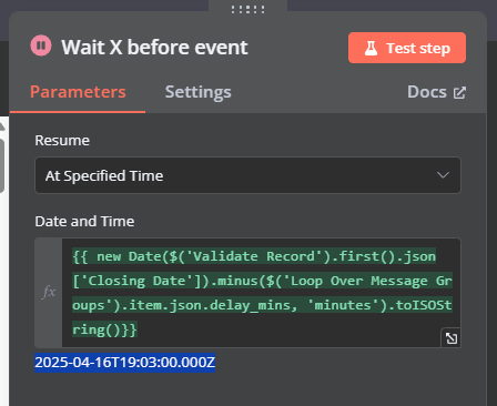

And now, I find that when I use the “At Specified Time” hard-coded option on the Wait Node, it doesn’t work either.
According to a moderator on this other post, the date should be pased in ISO format: so I passed it in ISO format.

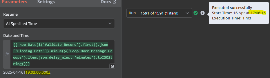

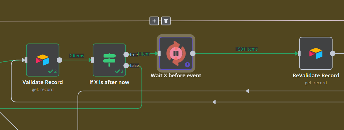

Not working either… That run from the screenshot started at 17:00
Had to continue running at 19:03
At the time of posting this, its 23:26 and the node just kept waiting infinitely.
No output, just infinite wait that breaks all my logic…

Hi @lyfterteam,
Try removing the milliseconds and the Z timezone marker at the end. For reference, something like this:
{{ new Date($now).toISOString().slice(0,19) }}
