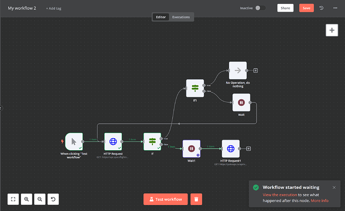

Hi, I am facing what seems to be a bug with the Wait node: when I wait for 1 minute, it works fine, but when I change the duration the node doesn’t wait, and at the same time keeps being on “Waiting” status in the execution logs. How should I do to resolve this?

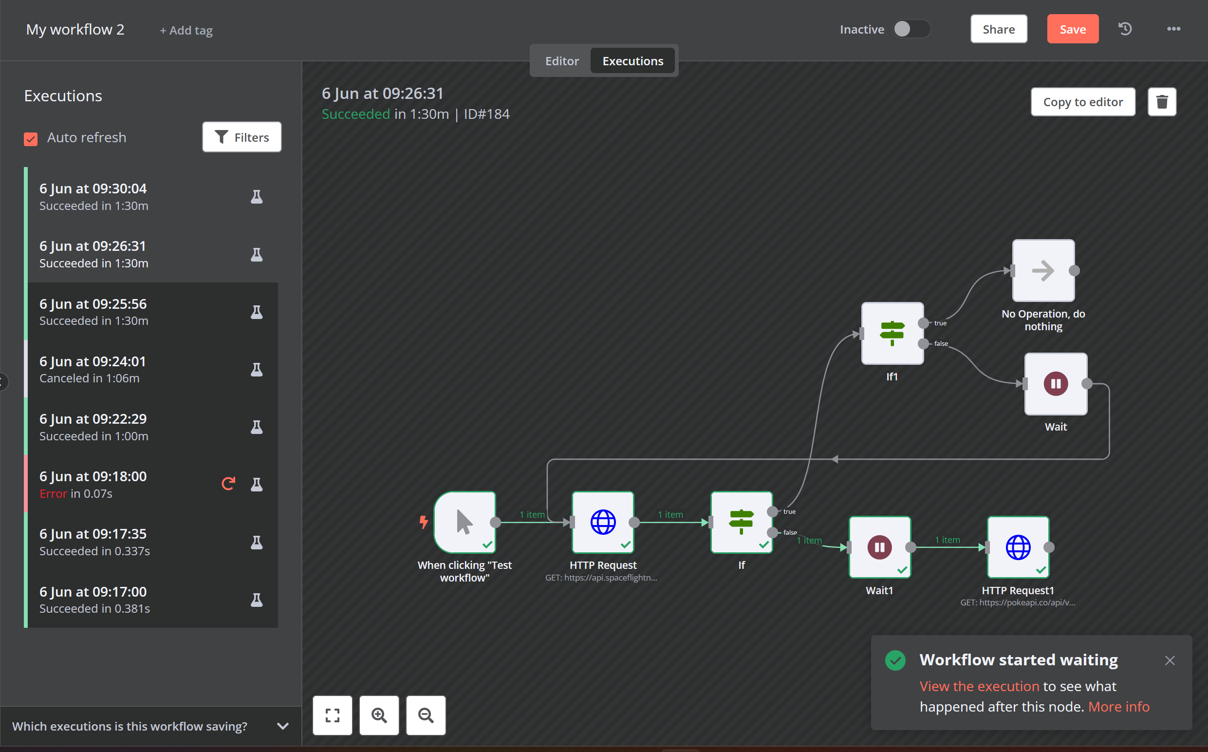

When a wait node runs for up to 64 seconds, the UI displays the running node and proceeds after the wait. But, from 65 seconds onwards, the wait is offloaded to the database, meaning that the UI won’t display the same way, and the execution result is shown in the execution log screen. Wait | n8n Docs
So, when you see this and receive that bottom warning, it means that the execution is waiting, and that its result should be viewed in the Executions screen.
Once in the execution screen you can see that the execution (which I started at 9h30 and set to wait for 1.5minutes) has indeed finished. Here you will also be able to open the nodes that come after the wait node and see that they have run and outputted data.
