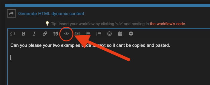

Can you try to embed the workflow? That will make it easier for me to try without needing to recreate the workflow. Just select all of the workflow nodes and copy. Then paste it in a codebock and it embeds. Make a codebock with this icon:
