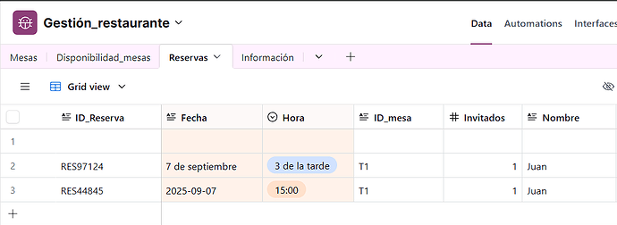

Hello, I have a voice agent connected on n8n connected to VAPI, I was wondering how you can change the date and time format that the webhook in n8n detects it as. As i specifically need to format to be “yyyy-mm-dd” and 24H for example 18:00 meaning 6pm. I will attached en example of it below.

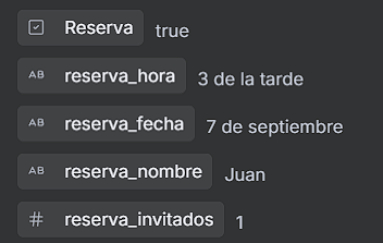

I need it to detect “3 de la tarde” (3pm) as 15:00. and “7 de septiembre” as 2025-09-07. If anyone has any experience with vapi or any idea on how to do this id highly appreciate it. Thanks.

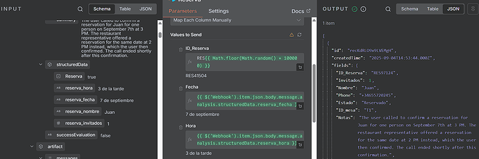

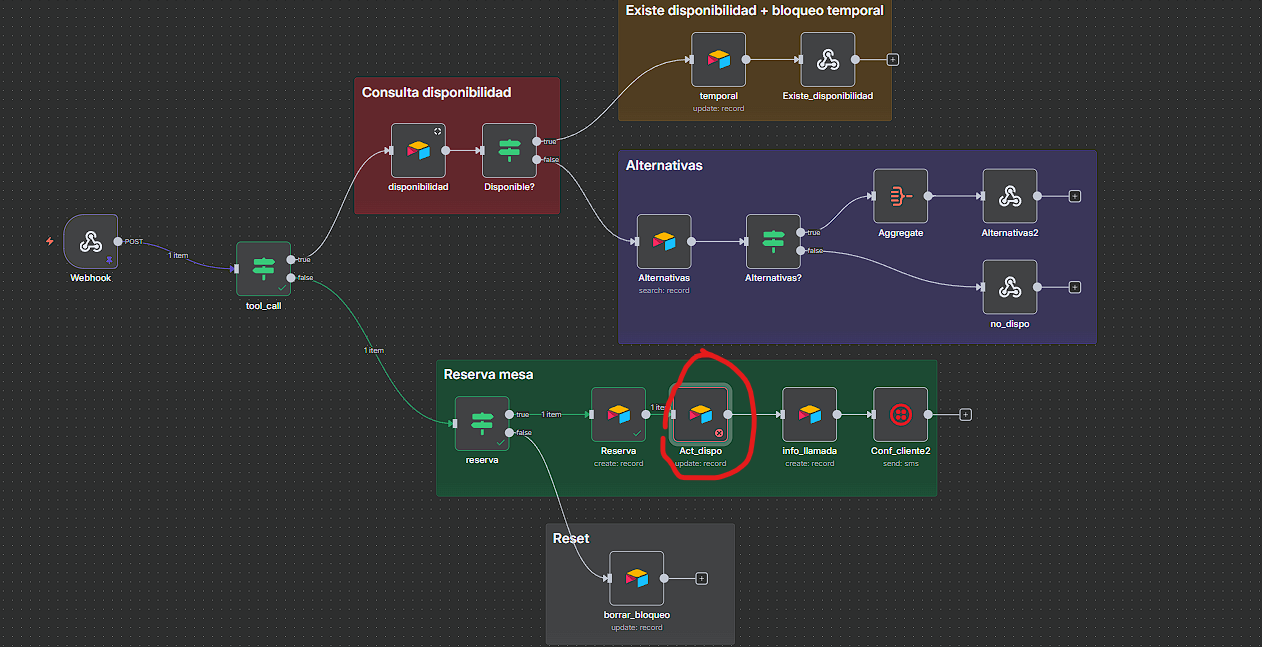

Currently i have the node below that detects the information from the webhook.
Which is giving me an error as the formatting is not yyyy-mm-dd and doesnt allow the data to match within the database sheet.

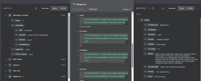

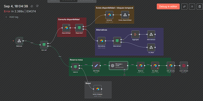

I have done it this way but the I am not sure how the ouput of the message model works.
The output of the reserva node is still the same as before and did not change.

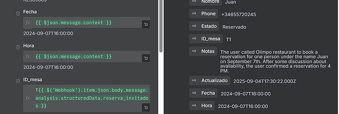

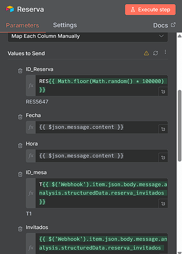

like this?
If you are asking if this is how you use the data from the output of the previous node - yes, it is. If on the other hand you are asking if this is what you are supposed to do - I have no idea, this is your flow, only you know the table, what needs to be filled… it does strike me as something that isn’t entirely correct because both “fecha” (date) and “hora” (hour) will be equal to 2024-09-07T15:00:00Z, which probably isn’t something you are looking for.
