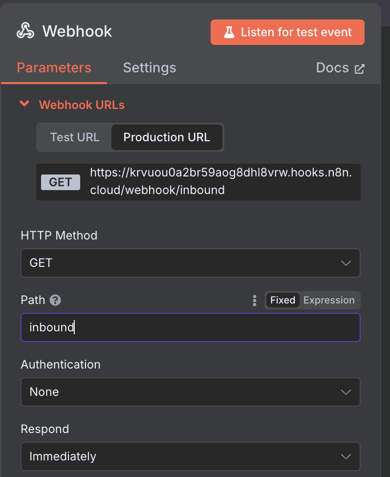

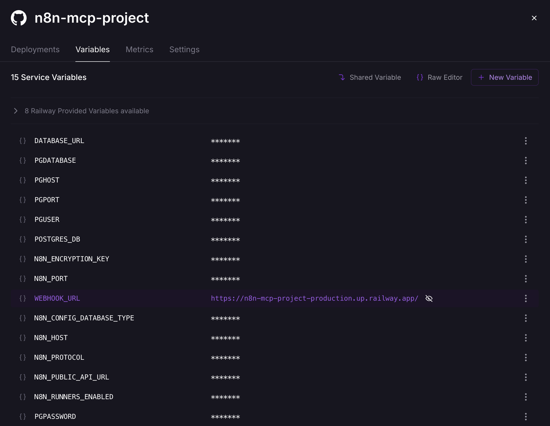

I have set WEBHOOK_URL in my environment variables. But it never works.
When I create a web hook in a workflow it always uses the n8n.cloud domain, not the domain I specify in WEBHOOK_URL.
I have also tried setting N8N_PROTOCOL and N8N_PORT and N8N_HOST.
Deployed using a Dockerfile on Railway.

How do you access your n8n instance?
From the screenshot, the link uses n8n cloud, but you mentioned that you’re self-hosting.
How did you set the WEBHOOK_URL?
What do your environment variables look like?
I access it here: https://n8n-mcp-project-production.up.railway.app
Hmm, did you install n8n using the Docker image or the n8n Railway template?
According to this link, you should also try setting N8N_EDITOR_BASE_URL=${{RAILWAY_PUBLIC_DOMAIN}}
