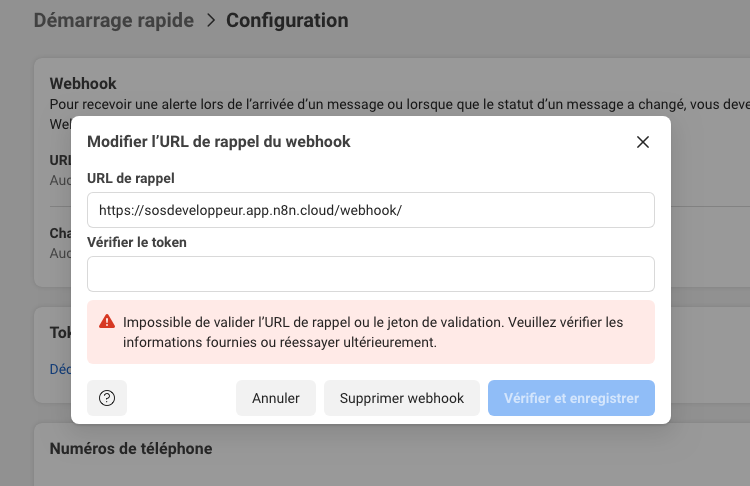

I read the posts but I can’t find the solution to create a simple WhatsApp bot. I have already created a whatsapp bot with botpress but I want to use n8n to add the langchain feature (vectors store), the memory…
I guess that my starting node is a webhook (type : POST) but when I go to the Meta Developer Console to add the webhook, I need to add a url and a token. What is the token ?

Hi @romeo_roy, creating webhooks can be a bit tricky but this should still work fine with n8n. What’s important is that WhatsApp requires you to have two separate webhooks as per their docs: “Verification Requests” and “Event Notifications”. The verification request is a GET request, while the actual events come through in a POST request. The token can have any value, it’s only meant to verify the authenticity of requests coming from Meta/WhatsApp.
In n8n this means setting up two Webhooks nodes with the same path but different HTTP methods, similar to what I’ve describe here for Okta. This is how a WhatsApp event workflow could look like assuming you pick a token of foo?:
I’d suggest you activate this workflow straight away and then use your production URL (and check your execution data for the results). Facebook seems to occasionally re-verify your webhook and this would fail if your workflows is inactive (or you are relying on manual executions using the test URL of your webhook nodes).
