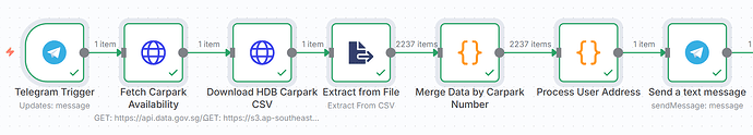

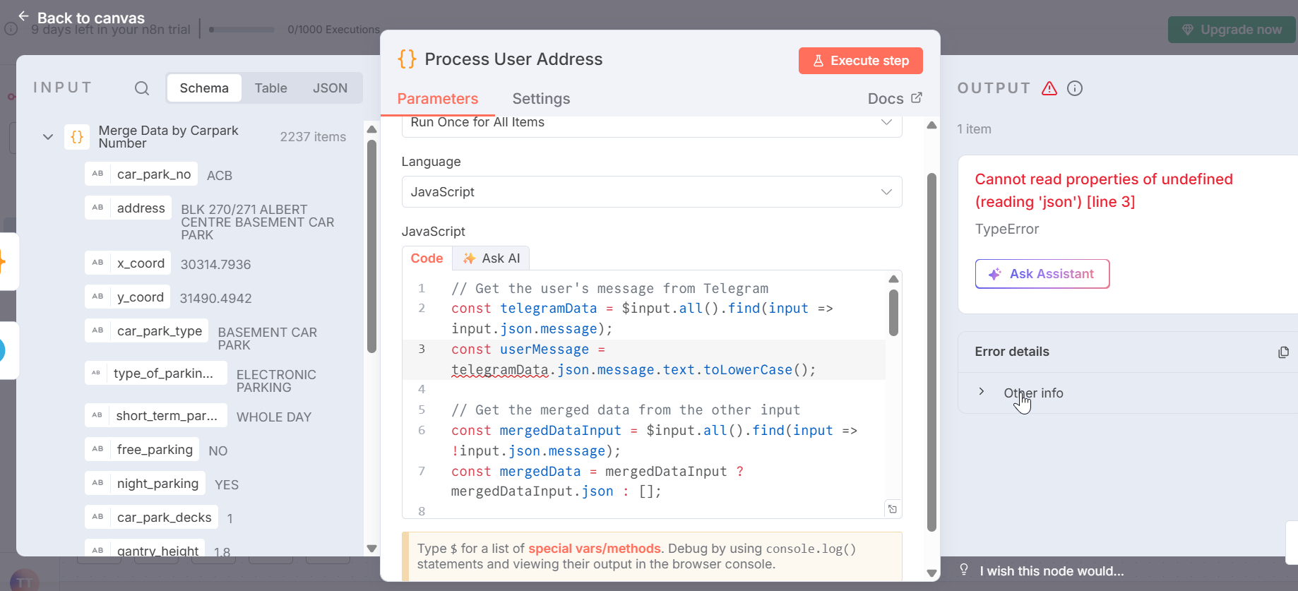

I have this flow which extracts the carpark availability data from API. I want the filter based on the input from the Telegram, and its filtered results sent to the Telegram.
Hey @TH1 hope all is well.

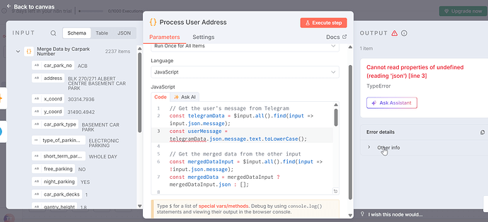

It is trying to tell you that telegramData variable doesn’t have the property json.
how should the filter be done then?
I don’t have your input data, if you wish to pin the data in the previous node and share it, we can take a look. Otherwise, most of the properties are hidden under the scroll.
If you want to see what the telegramData looks like, log it to console and see what’s what.
console.log(telegramData);
i think the telegram trigger receives 2 objects : update_id and message.
in your case $json.message is an object.
Since you receive text, you add $json.message.text

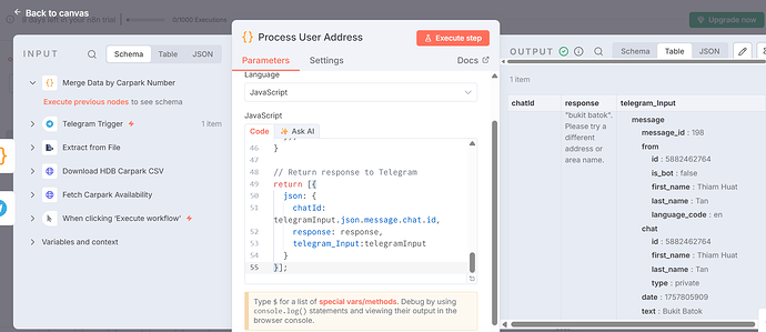

I key in ‘Bukit Batok’ in Telegram, so the input is actually under text. And I want to filter based on this text.

thanks for pointing out about the flow. I realize it is wrong. My new flow is as below:
I seem to have issue pinning the data, could it be that it is too huge?
It is very possible, you can share the JSON in the Google Doc, Github Gist or any other sharing service.
basically there are 2237 rows from Merge Data by Carpark Number, and I need to filter out those which contains the text entered from Telegram.

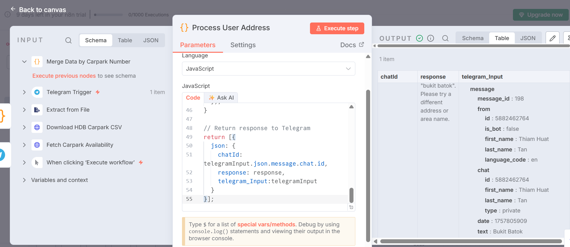

above is only part of it, so I need to filter by address which contains the text from Telegram.
Something like this?
wow, THANK YOU VERY MUCH. I am actually very lost in that JavaScript thingy to do this kind of filtering. Is the Python script going to be available for n8n soon? it seems to filter out correctly when the text is “Bukit Batok” as below, I will need some formatting to show each row in the Send text message, and will work on it.

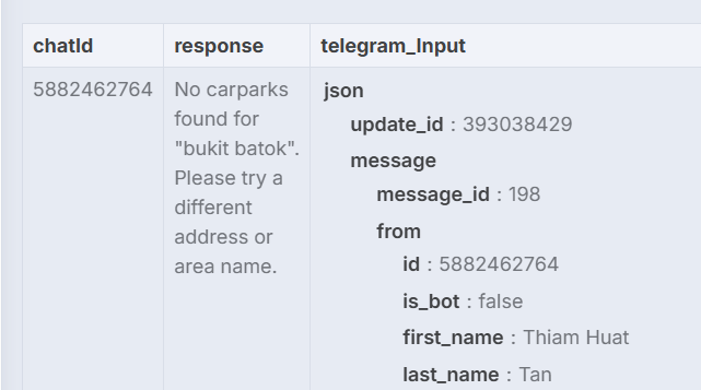

Telgram output:
Found 76 carparks for “Bukit Batok”:

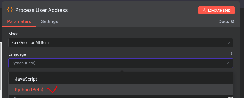

There is an option for python in the Code node:
I would still use the JS for now though.

Cheers
Do you have the expertise for this JavaScript to be converted to Python? I am still more comfortable with Python.
// Get the API data
const apiData = $(‘Fetch Carpark Availability’).first().json.items[0].carpark_data;
// Get the CSV data (assuming the CSV node outputs an array of objects)
const csvData = $input.all();
// Since the CSV node might output multiple items (each row as an item), we need to collect them
let allCsvData = ;
for (let i = 0; i < csvData.length; i++) {
allCsvData.push(csvData[i].json);
// Create a mapping from carpark number to availability from API data
const availabilityMap = {};
apiData.forEach(carpark => {
availabilityMap[carpark.carpark_number] = carpark.carpark_info;
// Merge the data
const mergedData = allCsvData.map(carpark => {
const carparkNumber = carpark.car_park_no;
return {
...carpark,
availability: availabilityMap\[carparkNumber\] || \[\]
// Now, we need to return the merged data as multiple items or a single item with an array?
// Since we want to pass multiple carparks, we return each as a separate item.
return mergedData.map(item => ({ json: item }));
