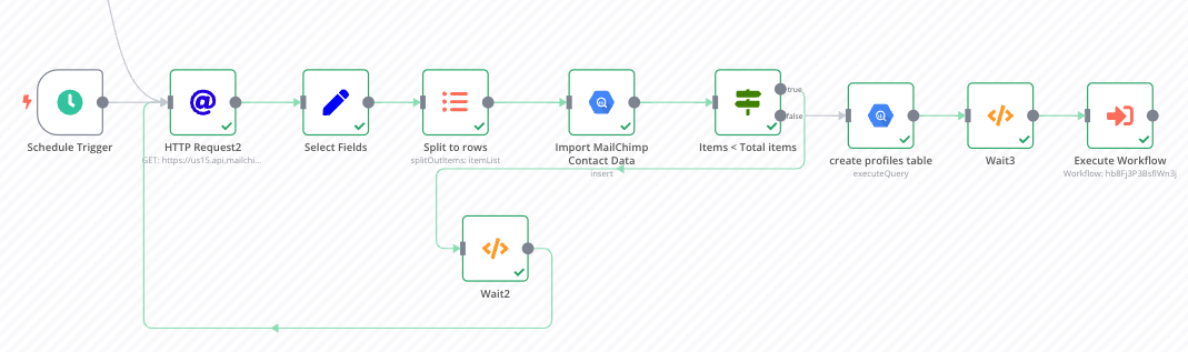

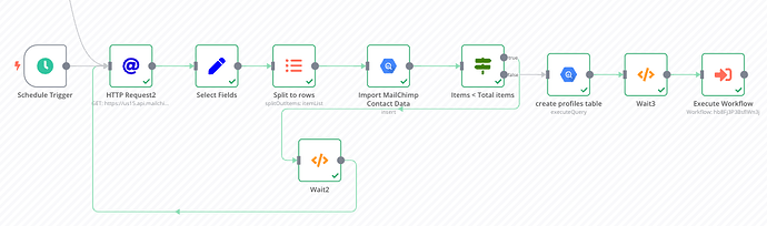

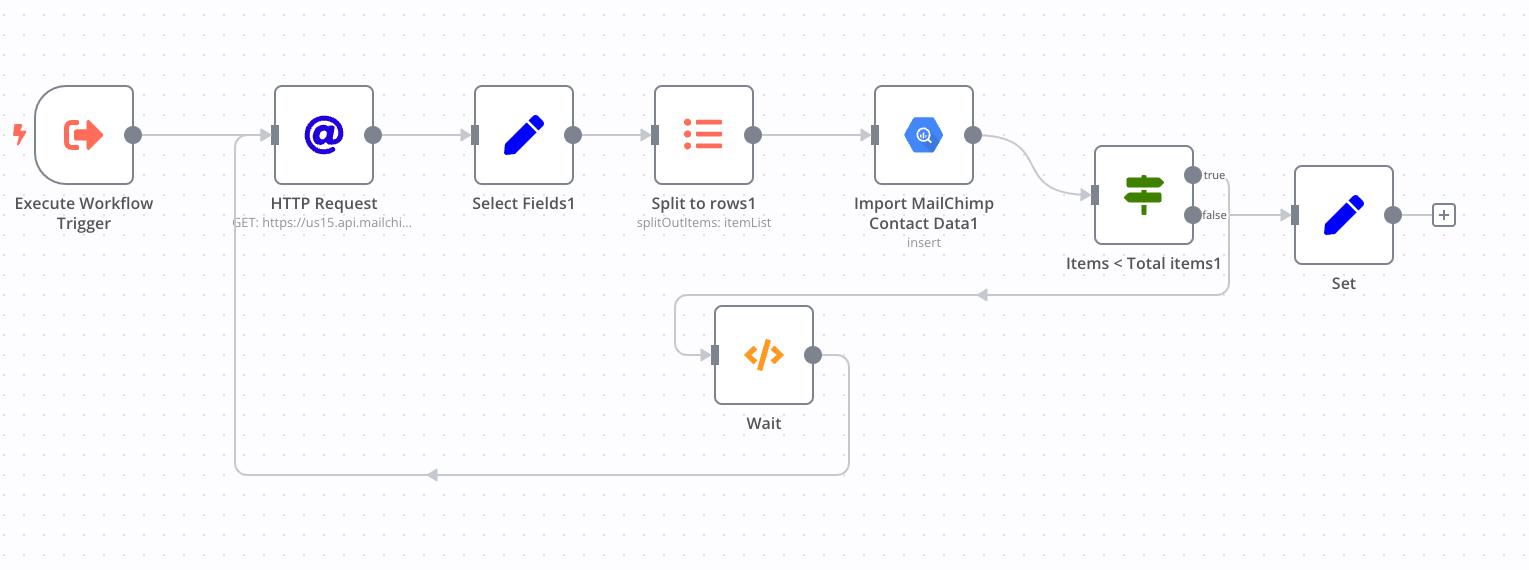

Hi @EmeraldHerald,
thank you for your response! I actually tried putting a set node in the end of the subworflow so that no data is transferred to the parent one but still get an error in the parent workflow. Subworkflow finishes successfully and parent workflow fails.
Parent:
Subworkflow:
