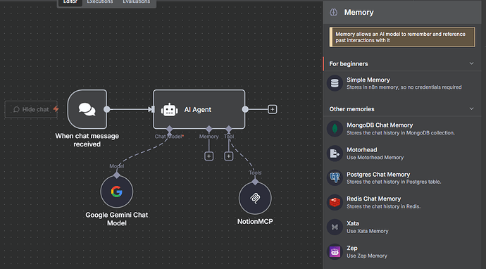

Here’s what’s happening, on the latest version of n8n, the zep memory tool can be added to their AI agent node.
Now once added, this implementation shows this warning:
And finally, adding my project keys lead to the following error:
I know that there are some clunky workarounds using HTTP nodes and calling the api directly. But zep has become a favorite among n8n users online, and I was looking forward to integrating it in my agents as well, so I thought I’d reach out to see if you’ve got a fix.
