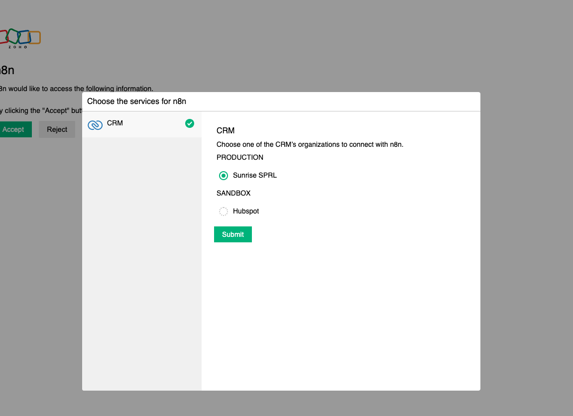

  • I choose the right org (prod)
  • I accept the message (these are the credentials needed etc…)

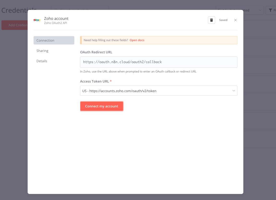

I’m not having any trouble connecting to Zoho :thinking: Is your access token URL set to the correct datacentre? Could this also possibly be a permissions issue within your organisation?

Can you double-check if your region is correct? I’m still not able to get the Zoho connection to error out unless I select the incorrect region :thinking:
OK you were right, the datacenter was the problem.
I choose US (because we sell in the US), but the datecenter is EU → now it works fine.
